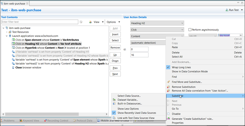

- In the ibm-web-purchase test script, select the test step where you enter ‘rational test workbench’ in the Search field.
In the User Action Details section, right-click ‘rational test workbench’ and click .

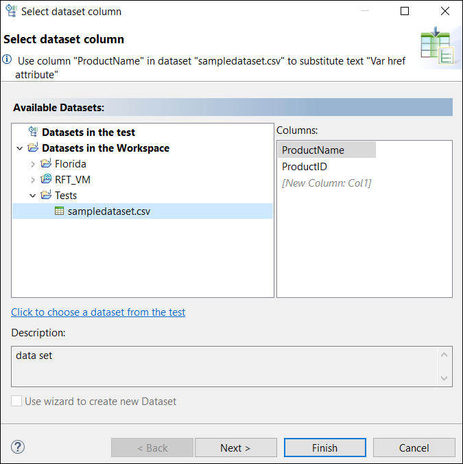

- In the Select Data Source dialog box, click Add Dataset.
Select the dataset that you created and click the ProductName column. Click
Finish.

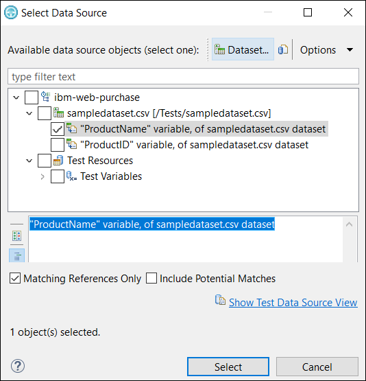

Select the ProductName check box and click
Select.
- You are prompted to do more substitutions. Click Cancel. Note that the color of ‘rational test workbench’ value has now changed to green. This change indicates that the value is substituted.
