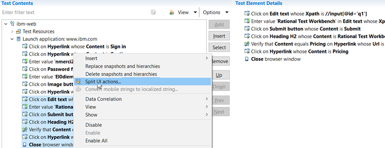

- Select the steps from ‘Click on Edit text … where you entered ‘rational test workbench’ in the Search field to Close browser window in the test script, both inclusive.
Right-click the selection and click Split Mobile or Web UI actions.

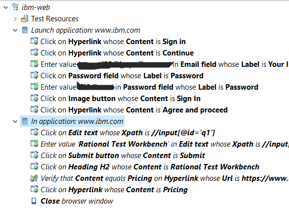

After Refactoring, examine the changes to be performed as a result of the split. Then, click Next.
The selected steps are added to a newly created node called the In application.
You will now add the steps that are in the In application node to a new test script.
