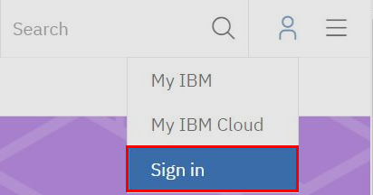

    1. Click the person icon and click Sign in.Sign in

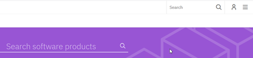

    2. Enter you IBM ID credentials and click Sign in.Search field
    3. Search for Rational Test Workbench.
