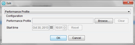

  3. In the Edit window, select Performance Profile. The performance profile options are displayed.
    Apply performance profile to a stub
  4. Select a performance profile.
  5. Select a start time. The start time represents the simulated time at which the first phase begins. The start time setting is used in conjunction with the start time that is configured in the response time properties of a stub, to determine at what point in the profile to begin when a stub is started. Use the start times to simulate the response times for a specific period in time, regardless of the actual time the stub executes. The selected time should fall within the period recorded in the performance profile, as defined by the profile's start time and the total duration of all of its phases.
