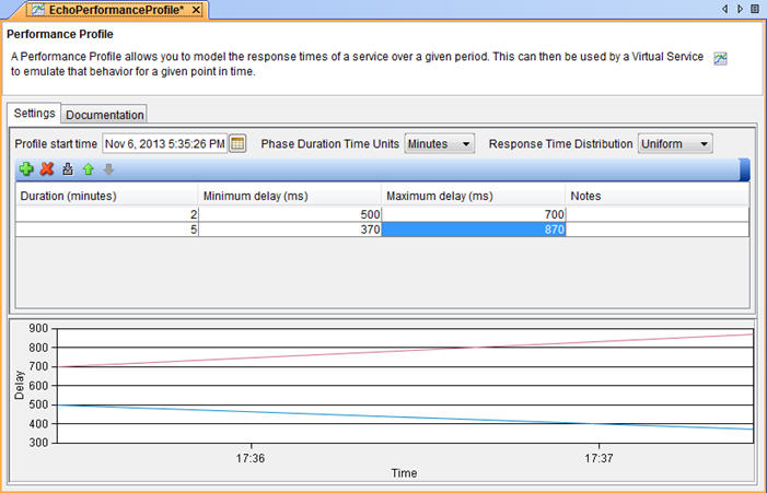

  6. To create a phase, click the Plus sign icon (+). A row is displayed with cells where you can enter values for each setting. As you add phases and data, a graph that represents the performance profile displays:
    stub performance profile with graph
    To alter displayed values, you can either change the values in the table, or drag data points in the graph vertically. If you drag the data points in the graph, the values in the table change to reflect the new data points.
