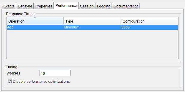

You can go to the Performance tab after you open the Stub Editor or Test Editor.
The image of the Performance tab.
For each operation in the Response Times section, select a delay type and type a configuration value. You can open the Edit dialog by double-clicking the operation. The following delay types are available:

Performance Profile Delays are based on a performance profile applied to the operation.
You can configure the Tuning section that applies to all operations for the following fields:
Field Description
Workers The maximum number of concurrent instances of this stub that can run at the same time. The default number is 10.
Disable performance optimizations
Enable or disable the performance optimizations for the stub for the operations configured.
