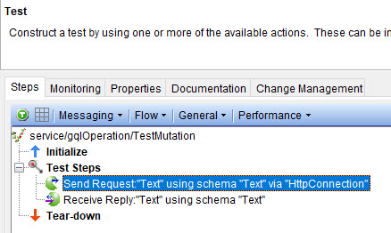

  1. Click the Send Request test step.
    A message is displayed in the message editor.

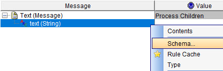

  2. Right-click text (String) in the Message field, and then click Schema.
    Image showing selecting the schema
    The Schema Selector dialog is displayed.

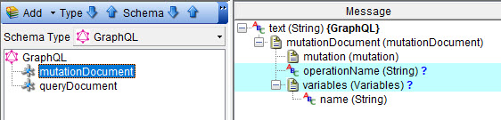

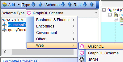

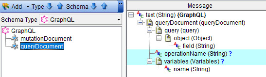

  3. Click the Schema Type field in the Schema Selector dialog, and then select the schema option as follows:
    Image showing the different GrqphQL schema types
    • Click Web > GraphQL to use the built-in GraphQL schema.
    • Click Web > GraphQL Schema to use the GraphQL schema you have imported into Test Integrations and APIs.
    The GraphQL schemas that you can apply to the message are displayed.

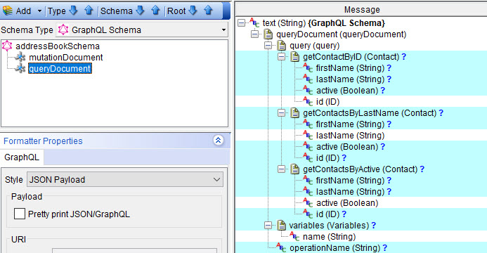

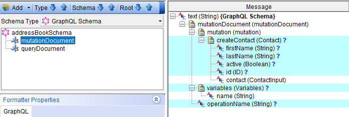

  4. Select a GraphQL schema document from the list.
    You can select from the following options:
    • mutationDocument
    • queryDocument
    You can find the schemas that are applied when you select any of the document type as displayed in the following table:
    Document type When GraphQL is selected When GraphQL Schema is selected
    mutationDocument schema for graphql mutation schema for graphql schema mutation
    queryDocument schema for graphql query schema for graphql schema query
