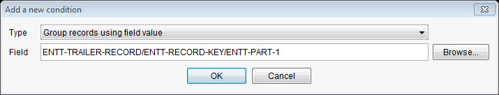

  6. Add conditions to the defining records by clicking New Condition.
    The new condition window
    Conditions are used to help Test Integrations and APIs understand the structure of the file that is being processed. If available for a condition, you can select a field within the record to use for matching the condition.
    In the example file schema that is shown, the file contains a header record, a number of group records, and a trailer (footer) record. Within each group record, one or more detail records can show.
    Record definitions can be moved and deleted by using the Remove Record, Move Up, and Move Down icons. Conditions cannot be moved, but they can be deleted by using the Remove Condition icon.

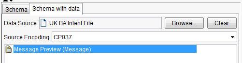

  7. In the Schema with data tab, click Browse to select the file resource (created in the Logical View) that defines the file to be processed.
  8. Select the wanted encoding type to apply from the Source Encoding list.
    A preview of the file to be processed is displayed.
    Preview of file schema
