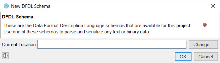

  1. In the Schema Library view of the Architecture School perspective, click the arrow next to the Add button, then click Other > DFDL Schema.
    The New DFDL Schema window is displayed.
    The New DFDL Schema dialog.
  2. In the New DFDL Schema window, click Change.

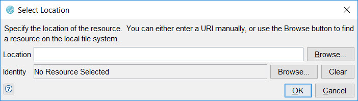

    The Select Location dialog.
  3. In the Select Location dialog, enter a full path to the file that contains the DFDL schema or click Browse, browse to the file, and click Open.
  4. Click OK when the correct path is displayed.
