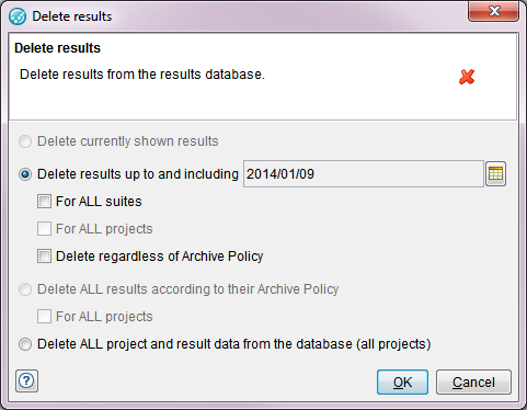

To delete test suite results from the Results Gallery, click the Delete icon Delete on the main toolbar. After you click the icon, the Delete Results dialog is displayed, providing you several options for how to delete result data.
Delete results
  • To delete only the displayed results (that is, the results of the currently selected test suite instance), enable the Delete currently shown results option.
  • To delete multiple result sets for the selected suite, enable the Delete results up to and including option and enter the date for which all results and all earlier results are to be deleted. When you are deleting multiple results, wildcard options can delete a broader range of data:
    • For ALL suites, you can delete results for all test suites before and including the selected date.
    • For ALL projects, you can delete all test suite results in all projects within the database before and including the selected date.
If any test suites are designated to be kept (see Notes), they are not removed by the delete action. For more information about commands that delete test results, see Managing test results.

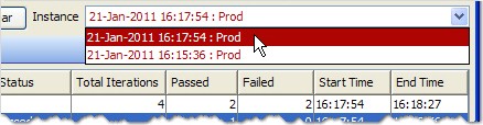

  1. Select Suite as the resource type, click Browse next to the Resource field, locate, and select the wanted test suite in the project resource dialog, then click OK.
  2. For the specified suite, select the execution instance from the Instance list. The date, time, and environment of each instance is displayed, and the status (passed or failed) of the instance is indicated by the color (green or red) of its entry.
    Test instance selection list
    If you do not see an expected instance, click the Reload icon Reload icon to refresh the contents of the list
The execution summary of the selected instance is displayed (top), and detailed reports for the instance can be selected in the report viewer area.

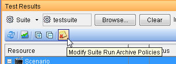

  2. For the specified suite, select the Modify Suite Run Archive Policies icon.
    View suite run history and change suite run archive policies

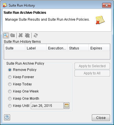

Tip:
You can change suite archive policies only if you set the application preference (Prompt for Suite Run Archive Policy) to run a suite with a policy.
The Suite Run History dialog opens. You can select, display, or delete one or more items in the suite run history. You can also change the suite archive policies to remove suite run history from the results database or change the time period to keep suite run history in the results database.
Important:
Suite archive policies do not apply to test suites that are run in a test cycle. The Suite Run History Items might not show any entries if all the test suites are run in a test cycle.
An empty suite run history
