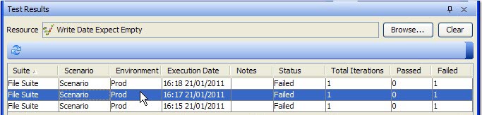

The summary report contains the following information:
| Column | Description |
| Suite | Displays the name of the executed test suite or test cycle that contained the selected test case at run time. |
| Scenario | Displays the name of the scenario in which the test case was executed. For test cycle results, "Test Cycle" is displayed. |
| Environment | Displays the name of the environment in which the test case was executed. |
| Execution Date | The time and date when the selected test case was executed. |
| Notes® | Indicates whether a note is saved for the selected test case or containing test suite. |
| Status | The status of the selected test case, either Passed or Failed. |
| Total Iterations® | The total number of iterations of the selected test case that were executed in the test suite. |
| Passed | The number of iterations of the selected test case that passed. |
| Failed | The number of iterations of the selected test case that failed. |

- To view the results of a specific test case instance, select that
test case instance:

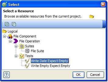

- Select Test as the resource type, click Browse next
to the Resource field, locate, and select the
test case in the project resource dialog, then click OK.
- For the selected test case, selected the specific execution instance
from the execution summary table below the resource field.
If you do not see an expected instance of the selected test case, click the Reload icon
to refresh the
contents of the table.
The detailed reports for the specified test case instance can be selected in the report viewer area.
