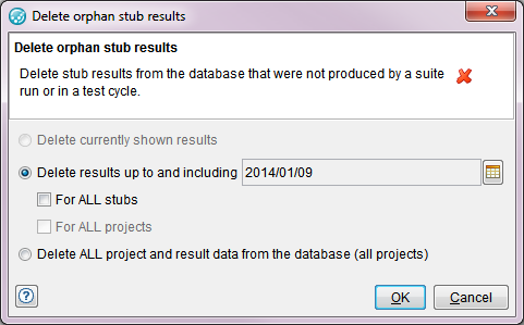

The results of one or more stubs can be deleted from the results database directly within the Results Gallery or from the command line.
Orphaned stub results are stub results that are not produced from running a suite or when produced as part of a test cycle. These orphan stub results can be deleted from the Results Gallery by clicking the Delete icon on the main toolbar of Test Integrations and APIs. After you click the icon, the Delete Results dialog is displayed, providing you several options for how to delete result data.
  • To delete only the selected results (that is, the results selected from the current stub), enable the Delete currently shown results option.
  • To delete multiple result sets for the selected stub, enable the Delete results up to and including option. Enter the date for which all results and all earlier results are to be deleted. You can use wildcard options to delete a broader range of data:
    • For ALL stubs, you can delete results for all stubs before and including the selected date.
    • For ALL projects, you can delete all stub results in all projects within the database before and including the selected date.
