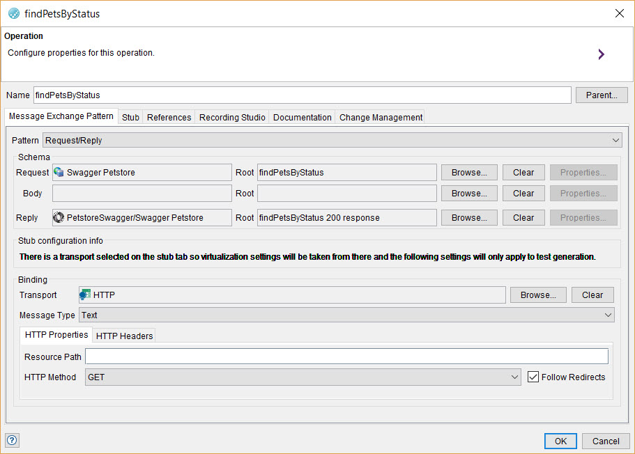

  1. Double-click the operation to open the Operation dialog box.
  2. Click the Message Exchange Pattern tab, if it is not already open.
  3. Select the messaging pattern that you want to use in your tests from the list in the Pattern field.
    You can select from the following options for the MEP that are listed for selection in the Pattern field:
    • Request/Reply
    • Publish/Subscribe
    For example, you can select the Request/Reply MEP.

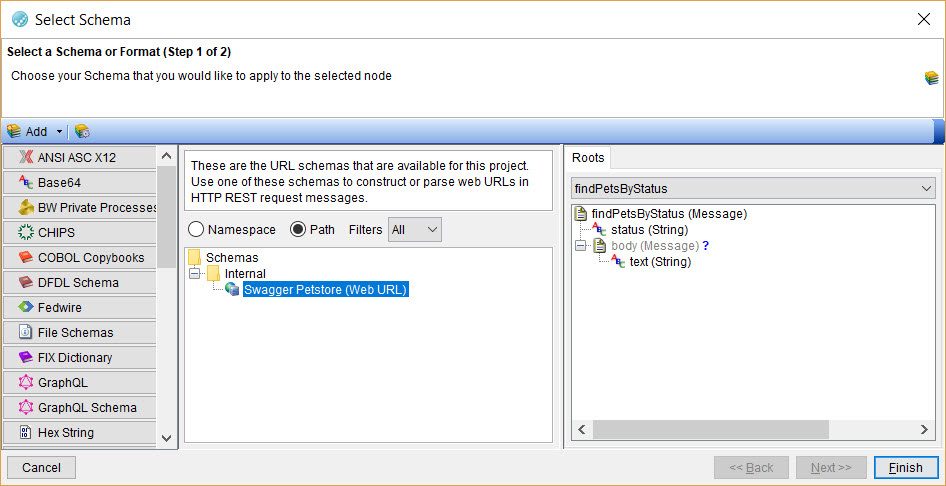

    1. Click Browse to select the schema and root for the schema for the outgoing messages for the Request or Publish pattern.
      For example, you can select the schema that you added for the Request pattern.
      The Select Schema dialog box is displayed.
      Image of the Select Schema dialog box.
    2. Select the schema that you want to use for the outgoing messages.
    3. Select a root for the schema by expanding the list in the Roots panel, and then select the root for the schema for the outgoing messages.
    4. Click Finish.

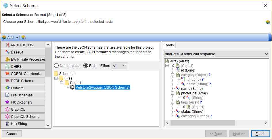

    5. Click Browse to select the schema and root for the schema for the incoming messages for the Reply or Subscribe pattern.
      For example, you can select the schema that you added for the Reply pattern.
    6. Select the schema that you want to use for the incoming messages.
    7. Select a root for the schema by expanding the list in the Roots panel, and then select the root for the schema for the incoming messages.
    8. Click Finish.
  5. Complete the following steps in the Bindings panel:
    1. Click Browse to select the physical transport and perform the following steps:
      1. Select the physical resource as the required transport in the Select a Resource dialog box.
        Refer to the following table for the options and the action you can take:
        Option Action
        No If you select No, you can select any transport in the project.
        Yes If you select Yes, you can select only transports that are referenced (directly or indirectly) by the operation that contains the test.
        Only Direct If you select Only Direct, you can select only transports that are referenced directly by the operation that contains the test.
      2. Click OK in the Select a Resource dialog box.
    2. Select the type of the message from the Message Type list.
    3. Configure the message properties for the messaging pattern.
      The options that are displayed are based on the type of transport that you select.
  6. Click OK to save the MEP settings and exit from the Operation settings dialog box.
