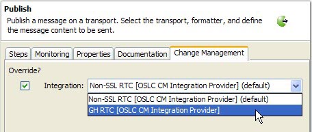

If multiple change management integrations are configured in the current project, you can override an inherited integration or the default integration under the Change Management tab. Here, you can specify a different integration to be used. Examples of inherited integration are integrations from an operation or service component higher up the project resource tree.
To specify a different or non-default integration for the current test, enable the Override option and select the existing integration from the list of available integrations. Ensure that you save the test after you change it.
