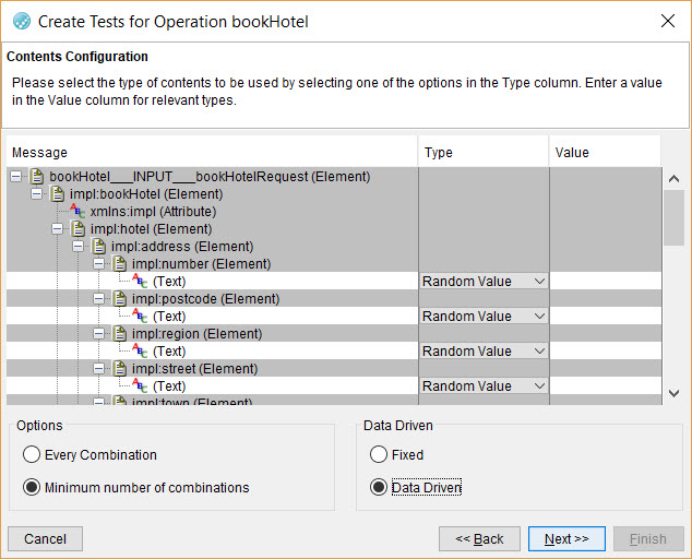

When you create tests you can opt to alter the occurrences of some of the message elements in the Structural Configuration dialog box or opt to change the value of the element type in the Contents Configuration dialog box.
You can create different tests for each of the content configuration or the variable test data that you set by selecting the Fixed option.
- A single data-driven test with multiple content iterations is created along with the test data in an Excel worksheet that specifies the values for the iterations which is used at test run time.
- Multiple data-driven tests with different test structures and content iterations along with the test data in different files that are used by each of the tests during test run time.

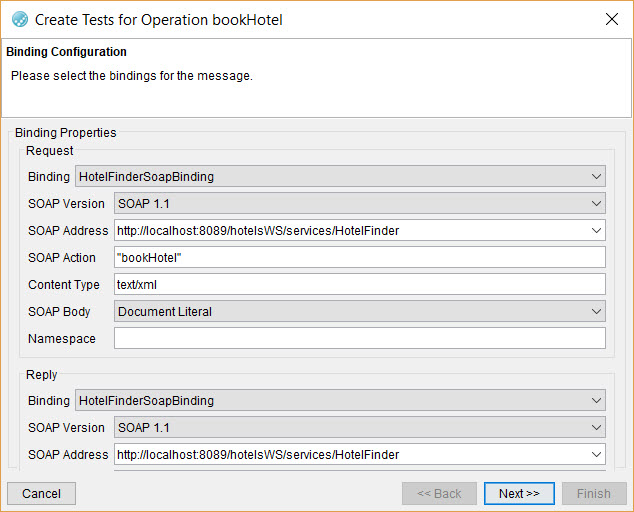

Note: If you created a test already, you can right-click the Tests folder or one of the existing tests, and then select .The Binding Configuration dialog box is displayed, if the operation that contains the tests has a WSDL as its parent.
Select the binding properties for the request and reply messages, and then click Next.

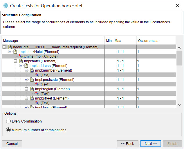

The Structural Configuration dialog box is displayed.
Perform the following actions in the Structural Configuration dialog box:
Perform the following actions in the Contents Configuration dialog box:

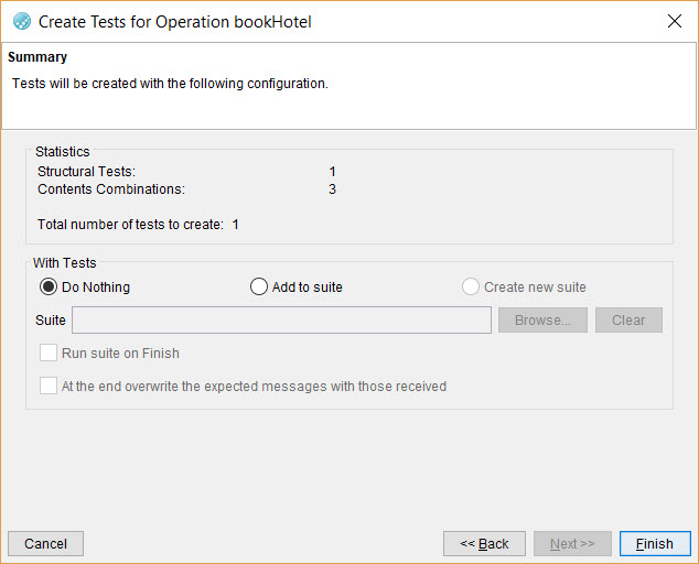

Select your action based on the options available in the With Tests panel as described in the following table:
Option Description Do Nothing Creates the tests as displayed in the Statistics panel. Note: This is the default option.Add to suite Adds the generated tests to an existing test suite that you select by clicking Browse, and then selecting the existing test suite. Create new suite Adds the generated tests to a new test suite, which you must name in the Suite field. Note: This option is enabled only if there are more than one test to be generated. If a single test is to be generated, you can only add it to an existing test suite and cannot create a new test suite.Run suite on Finish Runs the new or existing test suite when the MEP wizard closes. Note: This option is enabled if you select either the Add to suite or Create new suite option.At the end overwrite the expected messages... Overwrites the expected messages with the messages that are received when the tests are run. Note: This option is enabled if all of the following conditions are satisfied:- You selected the Fixed option to generate the tests.
- Alternatively, you selected the Data Driven option and you are able to create multiple data-driven tests with different structural tests, and then opt to add the generated tests to a new test suite.
- You selected the Run suite on Finish option.
- You must have configured a database as the Results Database in the Project Settings of your project, and the database is accessible at test run time.
- Click Finish to create the tests and return to the Test Factory main view.
