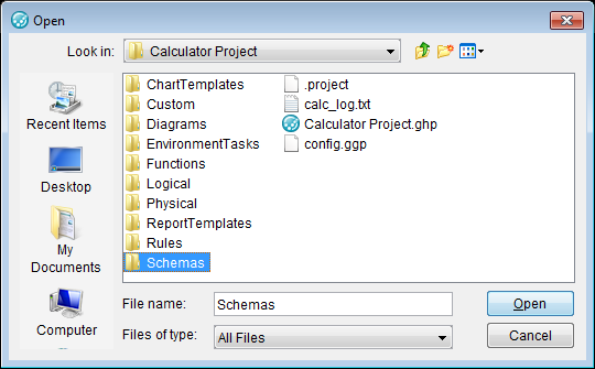

  1. On the toolbar at the top of the view, click Add.
  2. In the displayed browser, select a file, or a directory that contains multiple source files, for the schema to add.
    The project directory for the Calculator Project is shown.
HCL OneTest™ API examines the extension and the contents of the specified files. If it can determine the schema type, it adds the schema in the appropriate type and displays that page of the library. If it cannot, the schema is not added.
