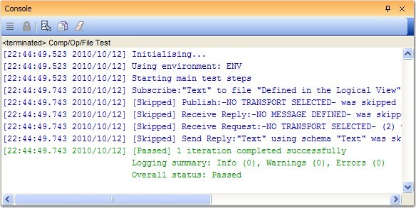

The Console
The Console displays the detailed execution status and results of the test asset that is selected in the Task Monitor.
The toolbar at the top of the Console provides shortcuts for manipulating the contents of the view.
Toggle line wrapping on or off.
Lock or unlock scrolling in the Console.
Select all text in the Console.
Copy the selected text to the clipboard.
Clear the contents of the Console.
