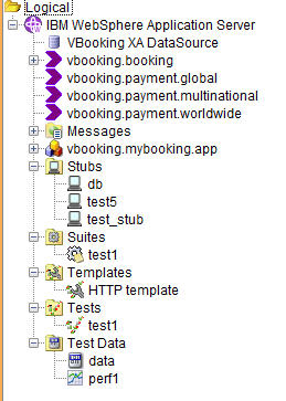

All test items are created in the Test Factory tree, on the left side of the perspective. Any test or test-related item that is created in the Test Factory can be edited in the editing panel, on the right side of the perspective.
The Test Factory tree
The Test Factory tree, to the left of the Test Factory perspective, contains all of your project resources such as components, operations, and test items. As tests and test items are added to the tree, they are automatically organized, by folder, under the operation in which they are created.
Test factory tree
  • To focus the view on a specific item, right-click and select Promote to Root from the menu. To restore the normal view, click the root of the tree and select Demote from Root from the menu.
  • To view the list of resources that are referencing an artifact in the project, right-click the artifact in the tree view. Click Find references. The tree view lists all the resources in the projects that has references to the selected artifact. To restore the view, click Search icon in the Test Factory toolbar and click Clear in the Search window.

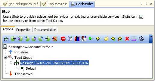

The editing panel is used to modify test items that are created in the Test Factory perspective.
Note: Items that are created in a different perspective (for example, messages, triggers) must be edited in their own perspective.
Test factory editing panel
Double-click any Test Factory item to open it for editing. Details about editing each item can be found in the following topics:
