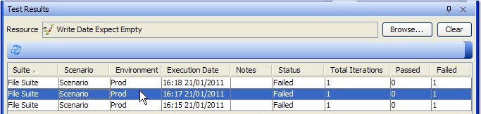

  • To reload the test case summary table, click the Reload icon in the toolbar.
  • To open the suite (in the Test Factory) in which the test case was executed, highlight, and right-click the test case instance and select Open Suite.
  • To copy the HCL OneTest™ API link to the selected test case results, highlight and right-click the test case instance and select Copy Link.
  • To view the results for the test suite in which the test case was executed, highlight and right-click the test case instance and select View Suite Results.
  • To view the results of a specific test case instance, select that test case instance:

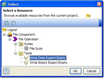

    1. Select Test as the resource type, click Browse next to the Resource field, locate, and select the test case in the project resource dialog, then click OK.
    2. For the selected test case, selected the specific execution instance from the execution summary table below the resource field. If you do not see an expected instance of the selected test case, click the Reload icon to refresh the contents of the table.
    The detailed reports for the specified test case instance can be selected in the report viewer area.
