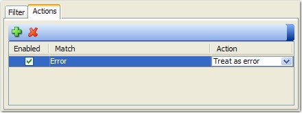

Log monitor actions
Under the Actions tab you can define specific test actions that are to be taken when a log entity matches the specified expression. When you monitor a log file during a test, you typically create actions that handle unexpected conditions (for example, errors or exceptions) in the log.
Note: Actions are matched in the order that they are defined in the editor. If no actions are defined or none of the defined actions are matched, the entry is sent to the test console as a normal message.
