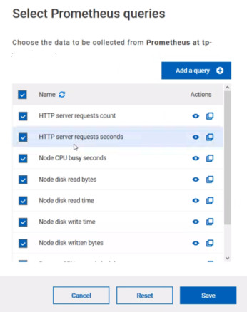

  3. In the Select Prometheus queries dialog, select queries that are available in the list to collect Prometheus metrics data by clicking the checkboxes.
    You can reset the selection.

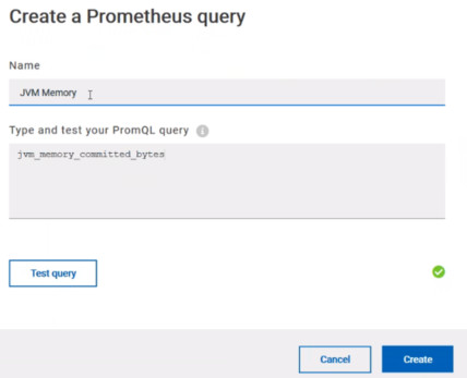

    1. Click Add a query.
    2. Enter a name for the new query in the Create a Prometheus query dialog.

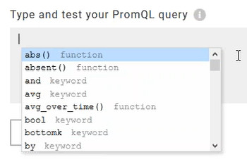

    3. Enter a PromQL query.any keyword and press Ctrl+Space in the Type and test your PromQL query.
      All the possible combinations of keywords and metrics related to your searched keyword are listed.

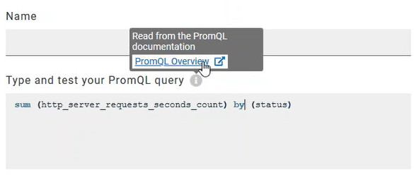

    4. Select a query in the list.
    5. Click the link that points to the 'Querying Prometheus documentation' page in the information tool tip to find other examples of queries in a web page that you can use as samples.
      Field where you enter a PromQL query
    6. Click Test query.
      If the test is successful, a green check is displayed, otherwise you get a red check with an error message.
    7. Click Create.
