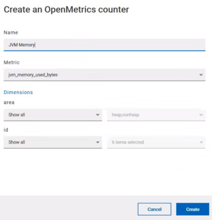

  4. Follow these steps to create a counter:
    1. Click Add a counter.
    2. Enter a name for the new counter, in the OpenMetrics counter.
    3. Select metrics in the drop-down list or enter a keyword in the Dimensions field to enable the dynamic input help. You can also use the search field that appears in the list of metrics.
      image of search for metrics

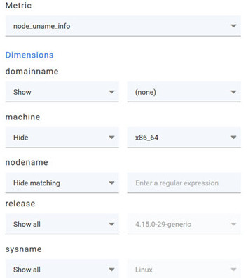

    4. Select Dimensions from the dynamic fields when they are required.
      Select different types of dimensions
    5. Select the appropriate OpenMetrics counter that you are looking for.
    6. Click Create.
      Create an OpenMetrics counter dialog
