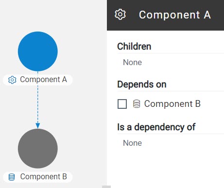

For example, if you define Component A to depends on Component B, then the relationship is displayed with a line arrow from Component A to Component B, and the arrow points to Component B.
When you click the Component A in the system model page, you can view that the Component B is listed under the Depends on section for Component A in the right pane.
Image of the depends on relationship.

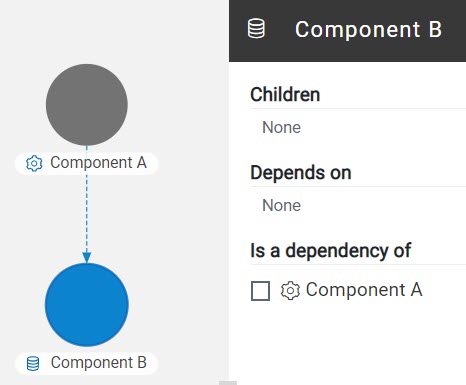

When you click the Component B in the system model, you can view that the Component A is listed under the Is a dependency of section for Component B in the right pane.
Image of the is dependency of relationship.
