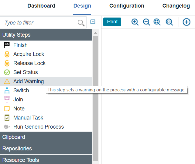

Warnings can be set on an execution by either of the following:
  1. Through the Add Warning plug-in step.
    This step requires a warning message as its only field. The warning message has a minimum length of 1 and maximum length of 2000. Empty string messages will be discarded.
    Add warning in process designer.

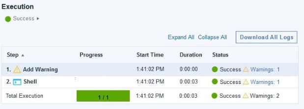

Scan the request history to locate executions that have warnings set and easily trace the warnings back to their originating plug-in step. The history and execution log pages will display the status of the execution alongside a warning indicator with count of warnings. This indicator will only display if there are any warnings from child activities that have not been ignored. Users can click warning count to view the list of warning messages from the plug-in steps of the executed process activity.
The history page will display a Status column that shows the execution status (Success or Failure) and also the count of warnings that had been set for that process. No count will be given if no warnings were set.
The execution log page displays each step and child execution. When the steps have completed the Status column will display the count of warnings in the same manner as the Request History page. In addition to displaying how many warning messages were set on a step/execution, you can bring up the warning messages for that step and any child steps underneath it. Below is an example of what messages would be available at each step in the execution log page. The shell with warning steps set a warning message.
