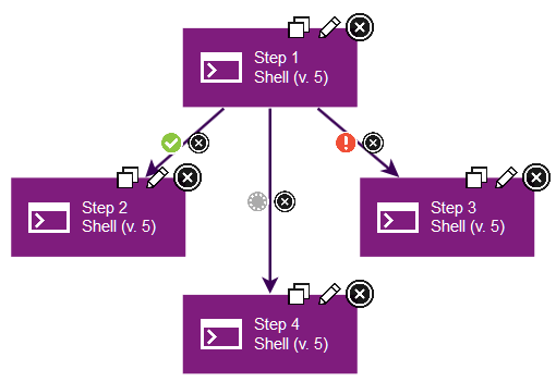

A step can have multiple connections with different conditional flags. For example, the following figure shows a step with three connections:
  • The connection to step 2 has a success flag. Step 2 runs if the first step finishes.
  • The connection to step 3 has a failure flag. Step 3 runs if the first step fails.
  • The connection to step 4 has a both flag. Step 4 runs regardless of whether step 1 finishes or fails.
A step that has three connections, each with a different conditional flag
