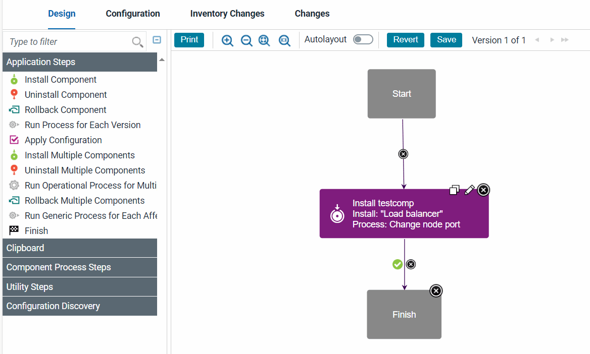

    The process editor, showing the editing area and the list of available steps
    When the Process Design pane opens, the Design view is displayed. Processes are assembled with the Design view. Available steps are listed at the left of the window. Deploy provides several utility steps and plug-ins. More plug-ins and documentation for those plug-ins are available on: HCL plug-ins website.

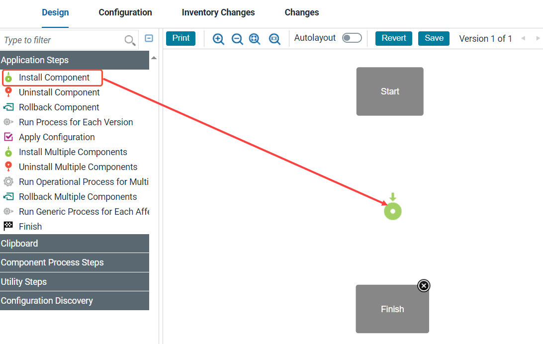

  2. To add a step:
    1. From the list of steps at the left of the window, drag the step to use onto the design space.
      Adding a step by dragging it from the list of steps to the design space

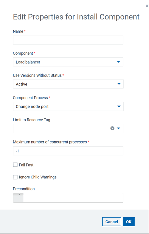

      To open the Edit Properties window, click the edit properties icon The edit properties icon. When you drag the first property on the design pane, you can place the step anywhere on the design space. Connection links are automatically created from the Start node to the step and from the step to the Finish node. When you add more steps, drag them and position them so that they highlight the connection link between stesps so that the step is inserted and connection links are automatically created between the steps. Steps can be dragged and positioned at any time. However, you must delete the connection links from the step by clicking the delete connection icon delete connection icon, and then reconnect the moved steps.
      A typical Edit Properties window, showing the properties for the step
      Configuration dialogs boxes are tailored to the selected step. Only parameters that are associated with the step type are displayed.
    2. Specify the properties for the step.
      Each step has different properties. See Plug-ins for information about configuring specific steps.

  3. Verify that the step connections create the required process flow:
    Connections control the process flow. The originating step runs before the target step. If you move steps or do not highlight a connection link when you place a step, creating a connection between steps is a simple process. You drag a connection from the originating step to the target step. Connections are typically formed automatically. However when you create them manually, connections are formed one at a time between two steps, the originating step and the target step. To create connections manually:

  5. Verify that the flow of steps is correct.
    Each process starts with the Start step and continues until it reaches the Finish step. Therefore, the Start step must connect to the first step or steps to run. Similarly, the last steps must connect to the Finish step, or else the process does not finish correctly.
