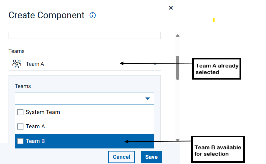

For example, say there are two teams: Team A, which is mapped
with a standard component type, and Team B. which is mapped with a standard
component and component type 2. You are member of Team A only and have the
Create with Team Assignment permission enabled. When you
create a component in HCL DevOps Deploy (Deploy), Team A
is selected automatically. In the Add Teams window, you can select Team B, which is
mapped with a standard component and Team B, which is also mapped with a component
type 2 even though you are not a member of Team B.

In the following figure, the Teams field opens in the Create Component window.
- Click the checkbox to select a team from the Team list.
- Select a security type for the object from the Type list. The type defines the set of object permissions that are available to the team. Security types for the current object type are available. Initially, a type of object, such as components, has a single type that is defined for it, the standard type. For information about security types, see Security types.
- Click Add. More than one team can
be added to an item.The selected team or teams can interact with the object immediately. Teams and their security type are listed on the Configuration page that is associated with the object. In the following figure, the NE-1 team with the cHolder security type is assigned to a component.
