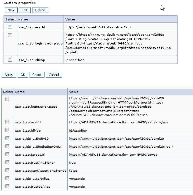

- For Custom Properties, you can use the information provided in the following illustration
as a guide:
For more information about custom properties, see the following help topic: http://www.ibm.com/support/knowledgecenter/SSAW57_8.5.5/com.ibm.websphere.nd.doc/ae/twbs_e nablesamlsso.html.

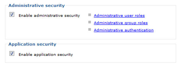

Ensure that SSO is enabled in WebSphere Global Security. These boxes must be checked in Security > Global security.

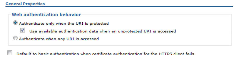

- For Security > Global security > Authentication > Web and SIP Settings > General Settings
>, you should have:
. This ensures that SSO is triggered if any

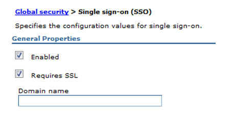

Compass Web resource is requested. - Single sign-on (SSO) >
If necessary, add a Domain name to trust. This would be the minimum part of the domain that matches your identity provider, for example, “.hcl.com”.

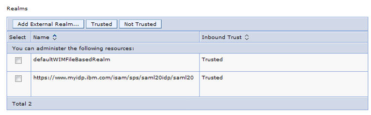

While you are here, ensure that the SAML Identity Providers realm is trusted. Go to Security > Global security. In user account repository, click Configure. Click Trusted authentication realms – inbound. Click Add External Realm and fill in the external realm name. Click OK and save your changes to the mastedr configuration.
Alternative steps, including wsadmin scripts, can be found in part two of the following help
topic: http://www.ibm.com/support/knowledgecenter/SSAW57_8.5.5/com.ibm.websphere.nd.doc/ae/twbs_c
onfiguresamlssopartners.html For example, the following shows WebSphere trusting the realm from an
IBM ISAM Identity Provider with the realm https://www.myidp.ibm.com/isam/sps/saml20idp/saml20.

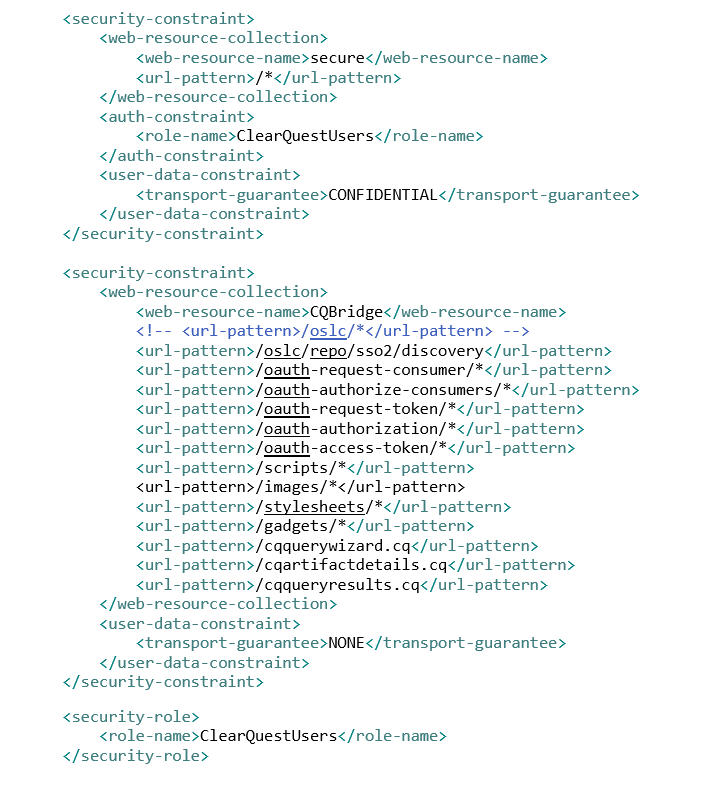

Reference the help topic Configuring client certificate authentication for Compass Web
to modify the web.xml descriptor, but for the security constraint and other clauses in web.xml use
the following:
