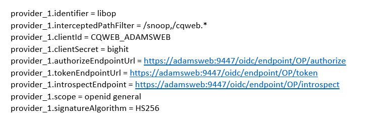

For custom TAI properties, reference this link (step 5-6)
Example settings where JAS is on host adamsweb port 9447.
- Add the com.ibm.websphere.security.InvokeTAIbeforeSSO (step 7-8) .

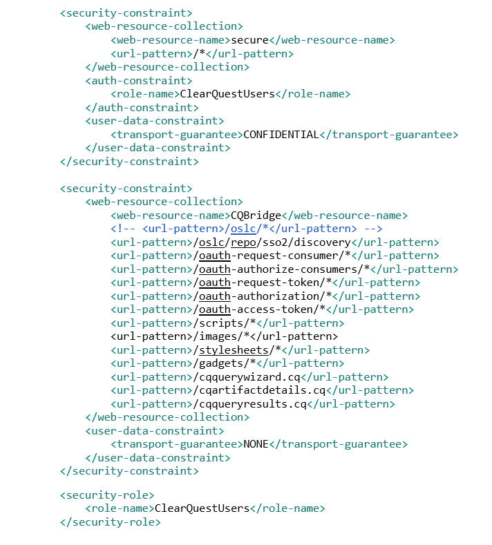

Configure HCL Compass Web server for SSO
Reference the help topic
Configuring client certificate authentication for HCL Compass Webto modify the
web.xml descriptor, but for the security constraint and other clauses in web.xml use
this:

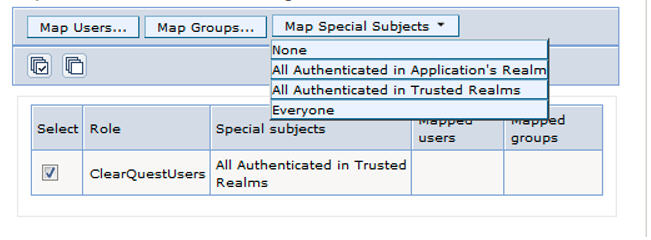

Map OpenID Connect users to HCL Compass Web application
The WebSphere profile hosting HCL Compass Web application must be told which users can access it. For now, we have chosen to allow all OpenID Connect authenticated users to access the HCL Compass Web login page. Just accessing the application does not mean they can actually log in to HCL Compass Web, it only means that they can load the HCL Compass Web resources in their browser. Whether they can actually log in to a HCL Compass database depends on whether the user is already subscribed to the HCL Compass database. For example, if the user “tom” is allowed access to the HCL Compass Web application but does not have any access to a HCL Compass database, they will probably only see the database selection dialog but will not be able to actually connect to the database.
- Using the WebSphere Application Server administrative console, click Applications > Application types > WebSphere enterprise applications in the navigation pane. The Enterprise Applications page opens.
- In the Enterprise Applications table, click TeamEar. The Configuration page opens.
- In the Detail Properties section, click Security role to user/group mapping.
- In the table row in which the HCL CompassUsers role displays, select the check box and click on Map Special Subjects and select
All Authenticated in Trusted Realms.
- Restart the WebSphere Application Server.

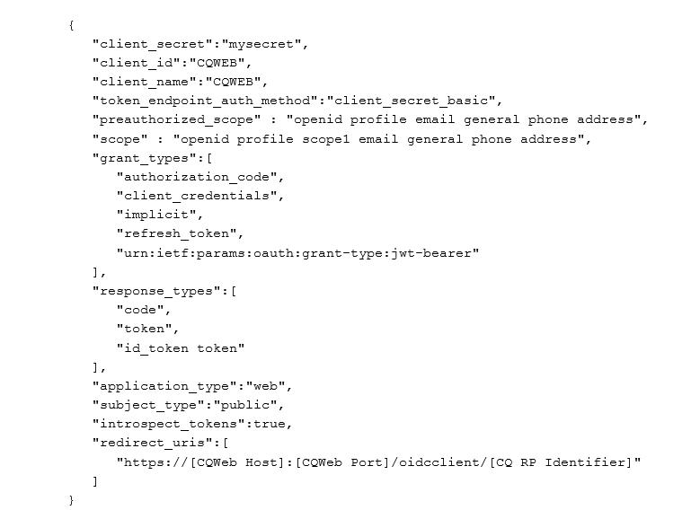

- Create a JSON file with the client registration JSON in it. Name the file cqwebreg.json.
You can use the same JSON that you would use for the RESTful registration described above. For
example,
Note: For parts in brackets [ ], you should supply values for your HCL Compass Web server. The HCL Compass RP Identifier is the provider identifier you gave in the custom properties for the RP TAI. In the example above, we used provider_1.identifier = libop, so here you would put “libop”. For example, https://host.mydomain.com:12443/oidcclient/libop.
