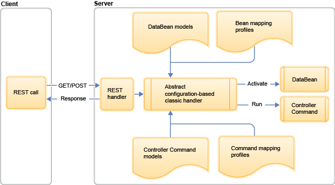

- Configuration of data bean and controller command mappings to REST
- To make REST calls to data beans and controller commands, mapping configuration files are used.
Where:
- A REST call is made to access a data bean (GET) or a controller command (POST).
- The data bean or controller command handler intercepts the call. It requests the configuration-based REST framework to set the properties for the data bean or controller command, activate, and return the response.
- The framework performs the following tasks:
- Introspects the data bean or controller command class to build
its model. This model is then cached. A RestException occurs if there
is a problem with the model.Note: Setter-methods that have the same name but take different parameters, for example, String versus Long, are considered. The ideal parameter is chosen, based on the data type passed in for the setter.
- Parses the mapping profile, so it can determine how to map from the REST call to the data bean or controller command. Then, map the response back to the HTTP format requested. For example, JSON. The mapping profile is then cached. A RestException occurs if there is a problem with the mapping file.
- Instantiates the data bean or controller command.
- Populates the setter-methods based on the mapping file and data that is provided from the REST call.
- Activates the data bean or runs the controller command.
- Constructs the response by using the mapping model to determine what response methods (getter-type methods) to call on the data bean or controller command.
- After all values are fetched, the response is returned to the main handler, and is then transmitted to the client.
