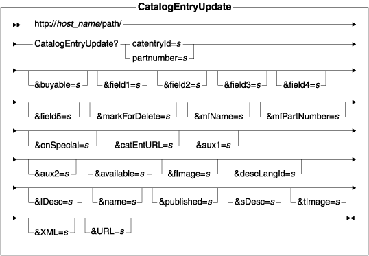

CatalogEntryUpdate URL
This URL updates an existing catalog entry. Note that the catalog entry type cannot be changed.
URL structure
- http:// host_name/path/
- The fully qualified name of your Transaction server and the configuration path.
Parameter values
- catentryId
- Required: The reference number of the catalog entry. You must specify either catentryId or partnumber.
- partnumber
- Required: The reference number that identifies the external part number of the catalog. You must specify either partnumber or catentryId.
- buyable
- Indicates whether a customer can purchase this catalog entry individually: 1=yes, 0=no.
- field1
- A customizable field.
- field2
- field3
- field4
- field5
- markForDelete
- Indicates if the catalog entry is marked for deletion for the Database Cleanup utility.
- mfName
- The name for the external manufacturer of the catalog entry.
- mfPartnumber
- The external manufacturer's part number of the catalog entry.
- onSpecial
- Indicates whether the catalog entry is on special.
- catEntURL
- The URL where the catalog entry is located.
- aux1
- An additional description for the catalog entry.
- aux2
- available
- Indicates the length of time before the catalog entry is available for purchase.
- fImage
- The full image path for the catalog entry.
- descLangId
- The description of the language's reference number.
- lDesc
- The long description of the catalog entry.
- name
- The language-dependent name of the catalog entry.
- published
- Indicates whether this catalog entry should be displayed for the language indicated by the descLangId: 0= no, and 1= yes.
- sDesc
- The short description of the catalog entry.
- tImage
- XML
- Reserved for HCL internal use.
- URL
- The URL to be called when the command completes successfully.
- keyword
- The search keyword associated with this catalog entry.
Example
The following example updates catalog entry 10002:
http://host_name/webapp/wcs/stores/servlet/CatalogEntryUpdate?
catentryId=10002&field1=3&keyword=
new keyword&URL=LogonForm
