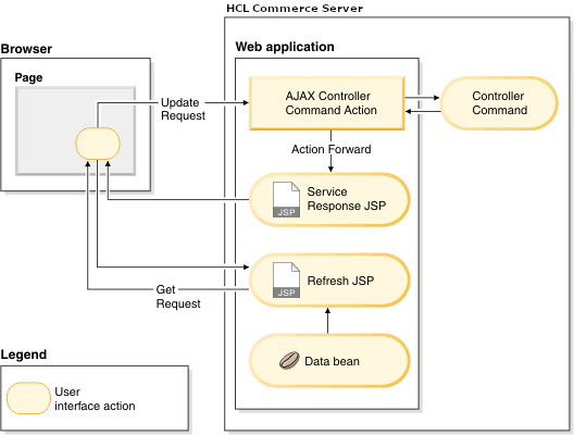

Interaction diagram when you call HCL Commerce controller commands:

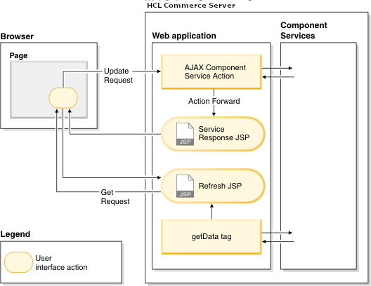

Interaction diagram when you call HCL Commerce services:
1. Making an AJAX call to an HCL Commerce controller command or service
Before the client is able to call an HCL Commerce controller command or service by using AJAX, the Transaction server must define that the controller command or service can be called by using AJAX (rather than the traditional programming model where the request is made and a new redirect is implied by the HCL Commerce run time).
To define a controller command or service to be available for AJAX type requests, simply define a new struts-action entry in the struts-config XML file that identifies the controller command or service as an AJAX type of action. For example, to create a new struts-action for the InterestItemAdd controller command that can be called by using AJAX, it must be defined it in the struts configuration XML file:
