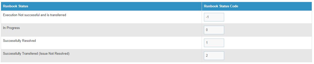

| RbaStatusCode | string | 1 | Refer below table. |

RbaStatusCode:
RbaStatusMessage: Output: { "statusCode": 200, "status": "Success", "message": "Runbook status updated successfully", " result ": null } } |
