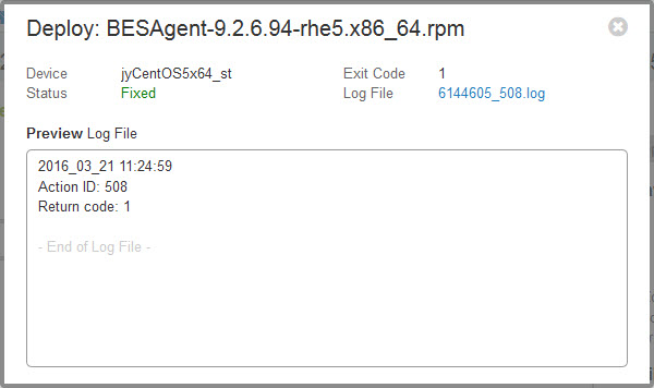

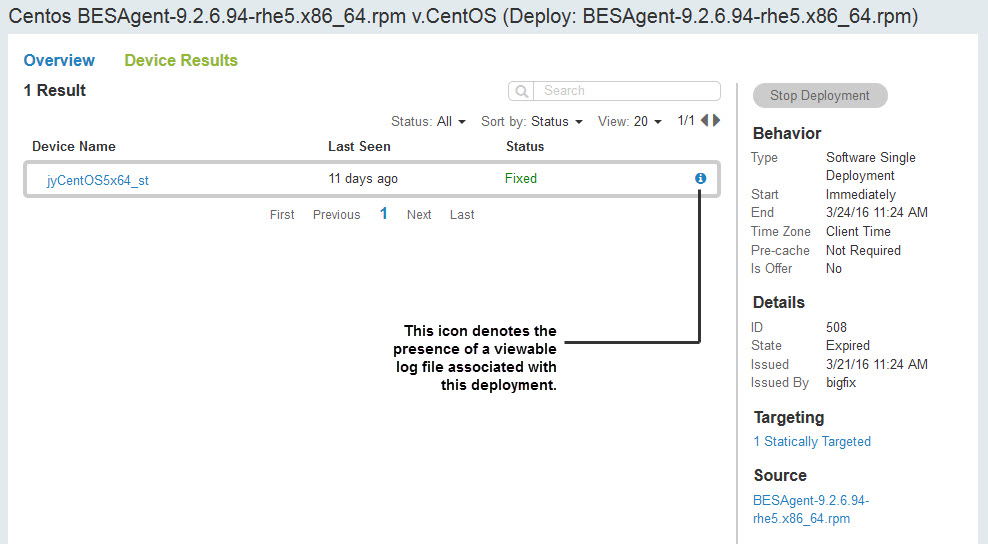

Software deployments might have an associated log file. This log can be viewed in the Device
Results screen. The presence of a viewable log file is denoted by an icon. Note that log files are
only available for software deployments.
Click the log icon to display the associated log data. The entire log can be downloaded by
clicking the log file name.
