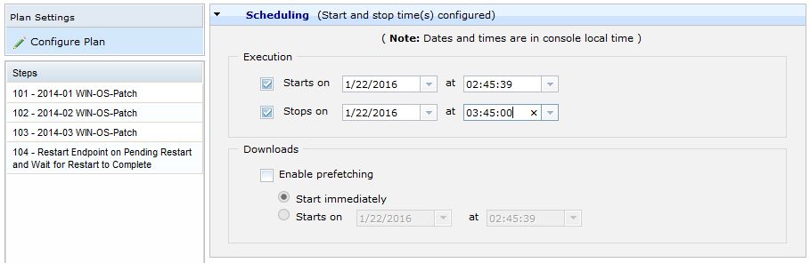

Scheduling an Automation Plan, setting a stop time, and prefetching downloads
You can schedule an Automation Plan to run at a specific date and time. The date and time that you specify in the Take Automation Plan Action panel is the BigFix console local time. The BigFix console converts the specified time to Coordinated Universal Time (UTC) and the Automation Plan Engine runs the Automation Plan at the specified UTC time. If the scheduled UTC time and date are less than or equal to the current UTC time and date, the Automation Plan Engine runs the Automation Plan immediately.

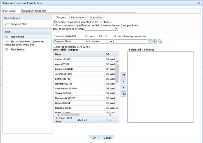

Complete the following steps to run or schedule an Automation Plan.
- Open the Server Automation domain.
- Select an Automation Plan from the list.
Click Take Action. The Take Automation Plan Action panel is opened. To schedule
the plan, specify a stop time, and prefetch downloads:
- To schedule the Automation Plan, click Configure Plan, enable the check box under Execution and specify the start time and date for the Automation Plan by selecting a date and time from the Starts on menu. You can also type values for the date and time in the Start Time field and the Start Date field. The time and date that you specify is the console local time. The default values of the Start Date list and the Start Time list are the current BigFix console local time and date.
- To specify a stop time for the plan, check the Stops on button and select the time and data on which you want the plan to stop. You can only specify a stop time if you have scheduled a start time.
- You can select the Enable prefetching option to download the relevant content required for each step in the Automation Plan in advance of the execution of the Automation Plan. If you select this option, an open action is created for each step in your Automation Plan.
- Select a step from the Steps list. By default, targets are not automatically loaded in the Available Targets list. If you want to load all available targets, click the search icon or press Enter. To view only the applicable endpoints for the selected step, select the Use applicability check box. To view all the endpoints that are managed by the BigFix server, clear the Use applicability check box. If there are no applicable endpoints for the selected step, the Use applicability check box is disabled.
- To filter computers or computer groups that you want to target based on their properties, use the lists and the input box. To add or remove filters, click + or -. After you enter the relevant criteria to search, click the search icon or press Enter to search.

- Repeat steps 5, 6, 7, and 8 for each step in the Automation Plan.
- To specify parameters for a step, select the step from the list and click the Parameters tab. For each parameter required by the step, a description and an entry field are displayed. If the parameter has a default value, the entry field contains the default. If the step has a saved default set of parameters, an icon is displayed to indicate this. To ensure the step runs successfully, each parameter displayed on the tab must have a valid value.
- To specify parameters for a failure step, select the step from the list and click the Failure Step Parameters tab. If the selected step has a failure step that requires parameters, a description and entry field is displayed for each parameter. If a parameter has a default value, the entry field contains the default. To ensure the failure step runs successfully, each parameter displayed on the tab must have a valid value. The failure step parameters are independent of the step parameters.
To run or schedule the Automation Plan, ensure
that all steps have one or more endpoints selected as targets and that all step
parameters have values, then click
OK. The following graphic shows an example of the Take Automation
Plan Action screen.
