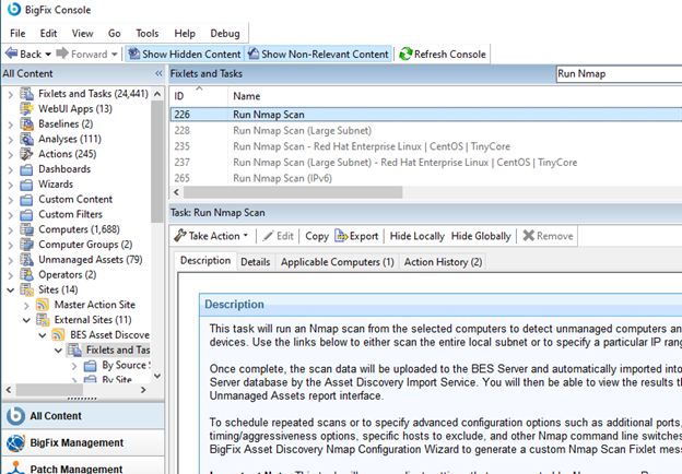

Select the Setup node in the Asset Discovery navigation tree to find all the task available to "Run Nmap Scan".
When the task opens in the work area, select one of the available links in the Actions box to initiate the Nmap scan. You can specify a local subnet:
Or a large subnet:
