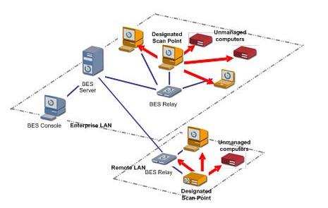

The designated scan points will scan their local subnets:

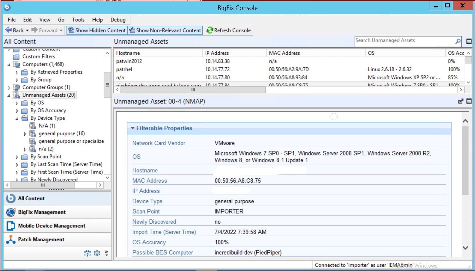

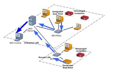

The result are then automatically sent to the BigFix Server, imported in the database, and available for view in the BigFix Console "Unmanaged Assets" tab:
