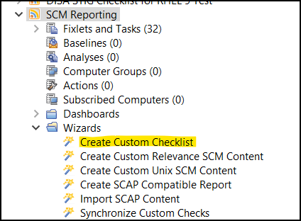

    Use the Create Custom Checklist wizard located in the SCM Reporting site under the wizard section.
    Figure 1. Create custom checklist
