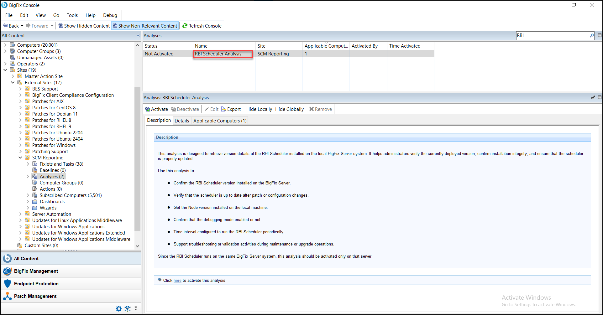

RBI Scheduler Analysis
The RBI Scheduler Analysis is designed to retrieve and confirm version and configuration details of the scheduler installed on the BigFix Server.
Use this analysis to quickly verify the following details:
  • Confirm the currently installed RBI Scheduler version.
  • Verifies that the scheduler is up to date after patch or configuration changes.
  • Get the Node version installed on the local machine.
  • Confirm whether debugging mode is currently enabled.
  • See the configured time interval for the periodic scheduler runs.
  • Support troubleshooting or validation activities during maintenance or upgrade operations.
Figure 1. RBI Scheduler Analysis
