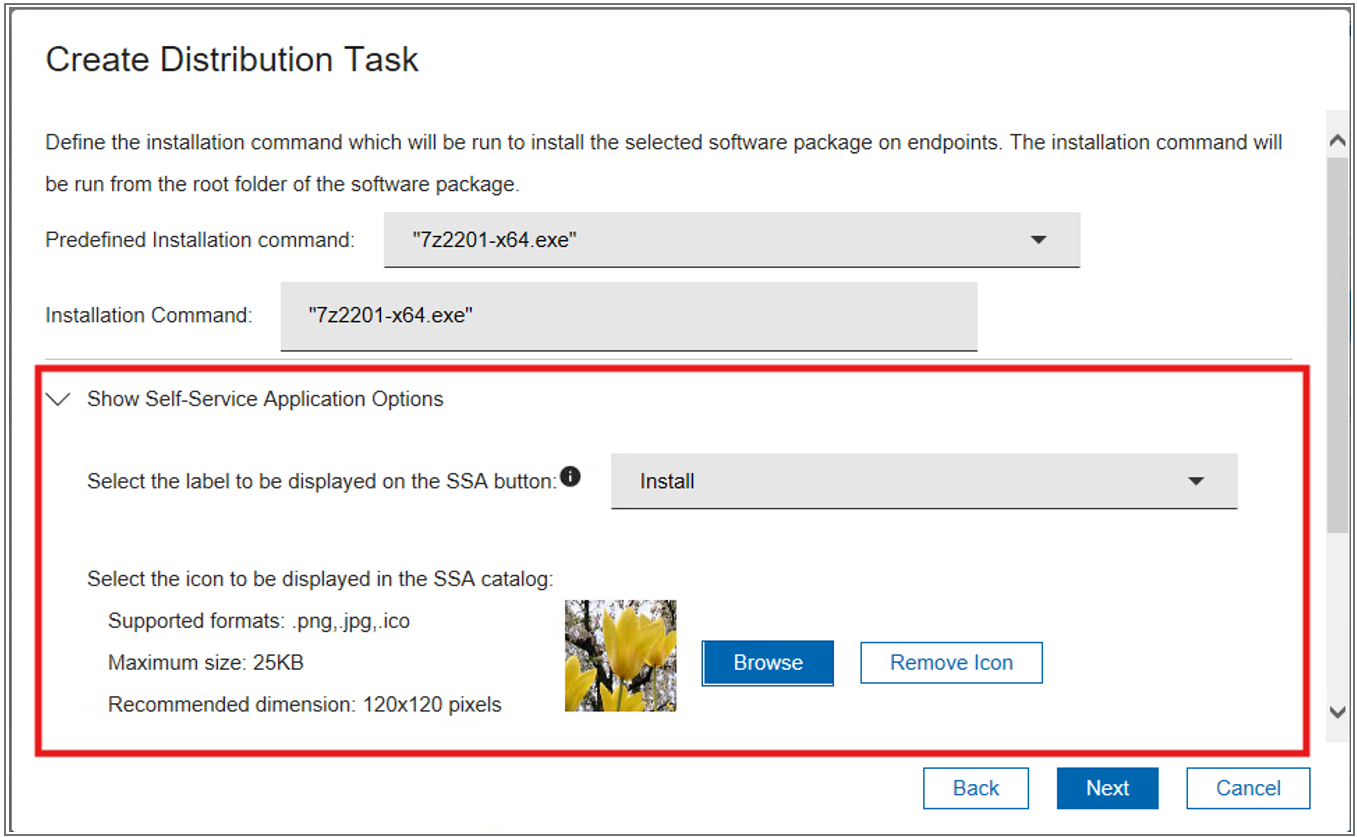

  1. From the Create Distribution Task window of the Manage Software Distribution Packages dashboard, click Next until you see Show.
  2. Click Show Self-Service Application Options.
  3. Click the dropdown to select the label to be displayed on the SSA button, and choose the desired entry from the list.
  4. Click the Browse button to select a custom icon from your device.
  5. Once the icon is selected, a preview will be shown, and a remove Icon button will appear in the modal.
    The file types supported for the icon are .jpeg, .png, and .ico. The size must be less than 25 KB, and the recommended dimensions are 120x120 px.
  6. Click remove Icon if you want to remove the custom icon from the task.
    Figure 1. Create Distribution Task window
