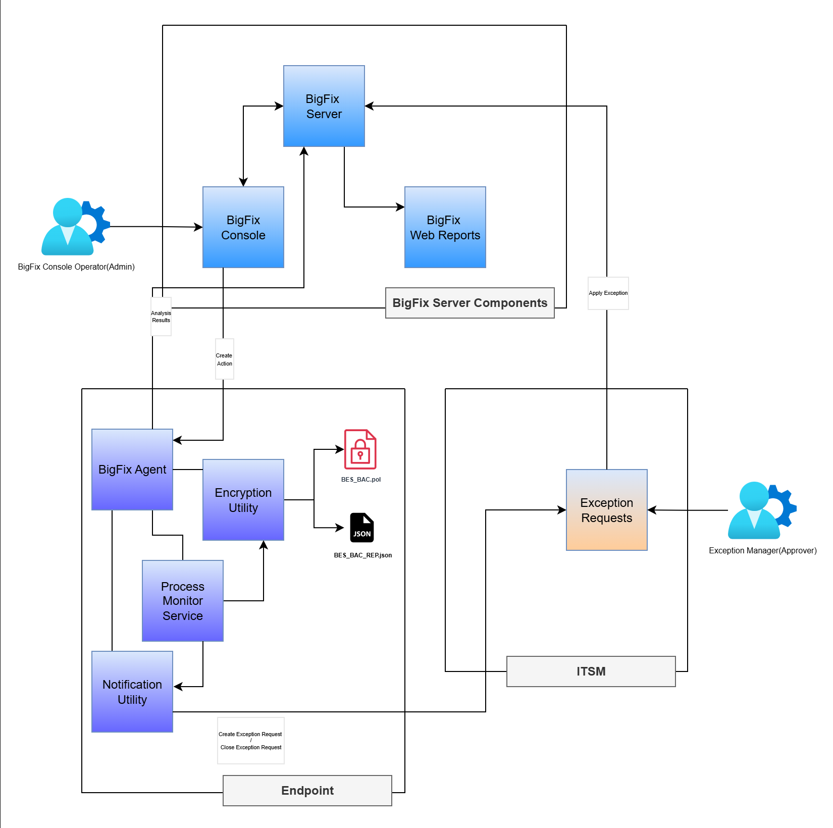

System Architecture Diagram
The system architecture diagram of Application Control.
For a better understanding of BigFix Application Control refer to its system architecture diagram below:
Figure 1. BigFix® Application Control Architecture
The above diagram shows how the BigFix Server components interact with BigFix endpoints and third-party ITSM applications (like ServiceNow for raising exception approval tickets).
The system architecture diagram illustrates the interaction between BigFix Server components, BigFix endpoints, and third-party ITSM applications/solutions, such as ServiceNow for exception approval tickets. This visual representation aids in understanding the structure and functionality of the BigFix Application Control system.
For Application Control to work properly, we need the following three components:
  • BigFix Server Components
    Application Control mainly utilizes the following three BigFix® Server Components:
    • BigFix® Core Server
      This is the central processing component for this solution. It manages all communications with the BigFix clients (agents), distributes content (like Fixlets, tasks, and analysis), and enforces policies. It is accepts REST API calls from ITSM applications/solutions (like ServiceNow) to execute action to allow the blocked app.
    • BigFix® Console
      The console is the primary administrative interface for BigFix Application Control. It is a key part of the server-side infrastructure used to manage all aspects of the environment, including creating content and deploying actions. All BigFix Console integrations will be in the External Site.
    • BigFix® Web Reports
      It provides a web-based interface for reporting and data visualization. The BigFix Agent on the endpoint runs an analysis and sends the result to the BigFix server. Below are the administrative reports that are shown for Application Control:
      • Effective Policy on Endpoint
      • Approved Exceptions
      • Endpoints With BAC Service
  • Endpoints
    There are three services running along with BigFix® Agent in the endpoint machines. The BigFix agent receives instructions from BigFix® console to install following services:
    • Process Monitor Service
      This component is deployed as a Windows® service, and will receive notifications of process executions using the ManagementEventWatcher class, and the service will compare the process meta data generated by the process execution events against the Effective Policy (bes_bac.pol) on the endpoint. If a process is to be blocked, the service will kill the process and initiate the Notification Utility to notify the logged in user of a blocked process. Default location for this service is C:\Program Files (x86)\BigFix Enterprise\BES Client\BAC\.
    • Notification Utility
      Since the Process Monitor Service will be running in a non-interactive session, a notification utility is there to enable notification of the logged in users for a blocked process event. Upon invocation, this utility presents the logged in user with an alert indicating that a process has been blocked. Default location for this service is C:\Program Files (x86)\BigFix Enterprise\BES Client\BAC\
    • Encryption Utility
      Encryption Utility is used to encrypt and decrypt the data into files. Latest payload data is encrypted through this utility and updated into the bes_bac.pol file and the latest payload data (in decrypted form) is updated to the bes_bac.rep file for reporting on BigFix® Web Reports. Default location for this service is C:\Program Files (x86)\BigFix Enterprise\BES Client\BAC\
  • ITSM Applications (like ServiceNow)
    ServiceNow is an ITSM application/tool where each exception raised from the endpoint through Notification Utility is created as a ticket. This ticket needs to be approved by the exception manager. Once the ticket is approved, BigFix Action API is called to send the approved exception to the respective endpoint and allow the blocked application on that endpoint machine. When an endpoint receives the approval for an exception, an action is executed to update the ServiceNow ticket with the status: fulfilled/completed. From the endpoint machine, an unauthenticated ServiceNow API is called to raise an exception on the blocked application.
