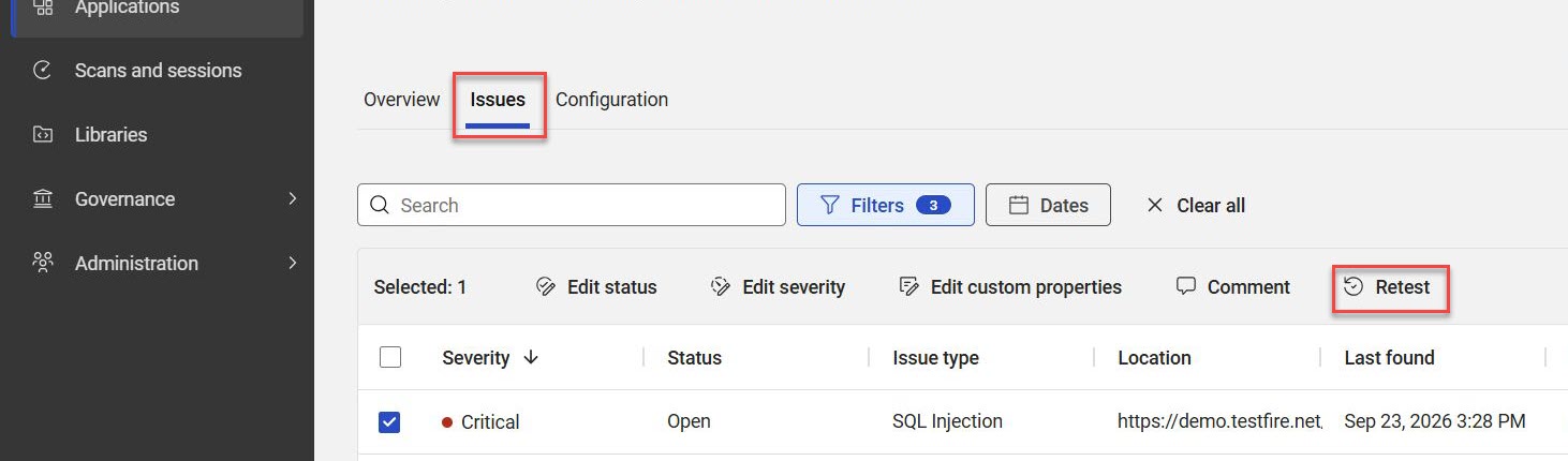

    Scan Issues tab with one issue selected and the Retest action available.
    • Table action bar (single or batch issues): Select the checkboxes next to the issues that you want to retest, and then select Retest on the table action bar.
    • Issue details menu (single issue): Select an individual issue row to open the details pane, select the More Actions menu (Three-dot action menu), and then select Retest.
  4. In the confirmation dialog, select Retest to start execution.
