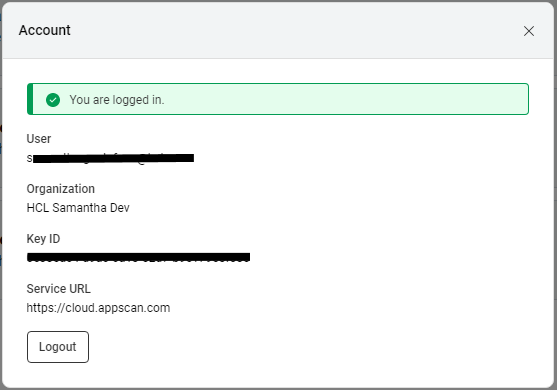

Account information
To access account information, select Settings > Account.
If you are not currently logged in to AppScan on Cloud, first provide a key ID and key secret. AppScan Go! identifies and populates the Service URL field with the appropriate information.
If you are already logged in to AppScan on Cloud, the Account dialog box lists the current user, the user's organization, the key ID, and the URL of the AppScan service currently in use. To logout, or switch to a different user account, click Logout to log out of the currently connected AppScan service.

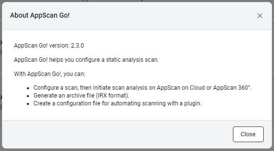

  • Select Help > About to access the About AppScan Go! dialog box.

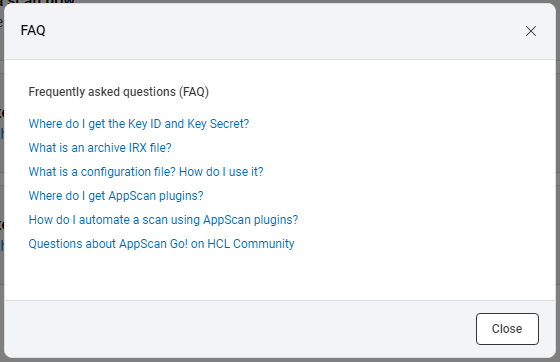

  • Select Help > FAQ to access the FAQ dialog box.
    Click on any of the questions to launch the online help in a new browser tab with information answering the question.
