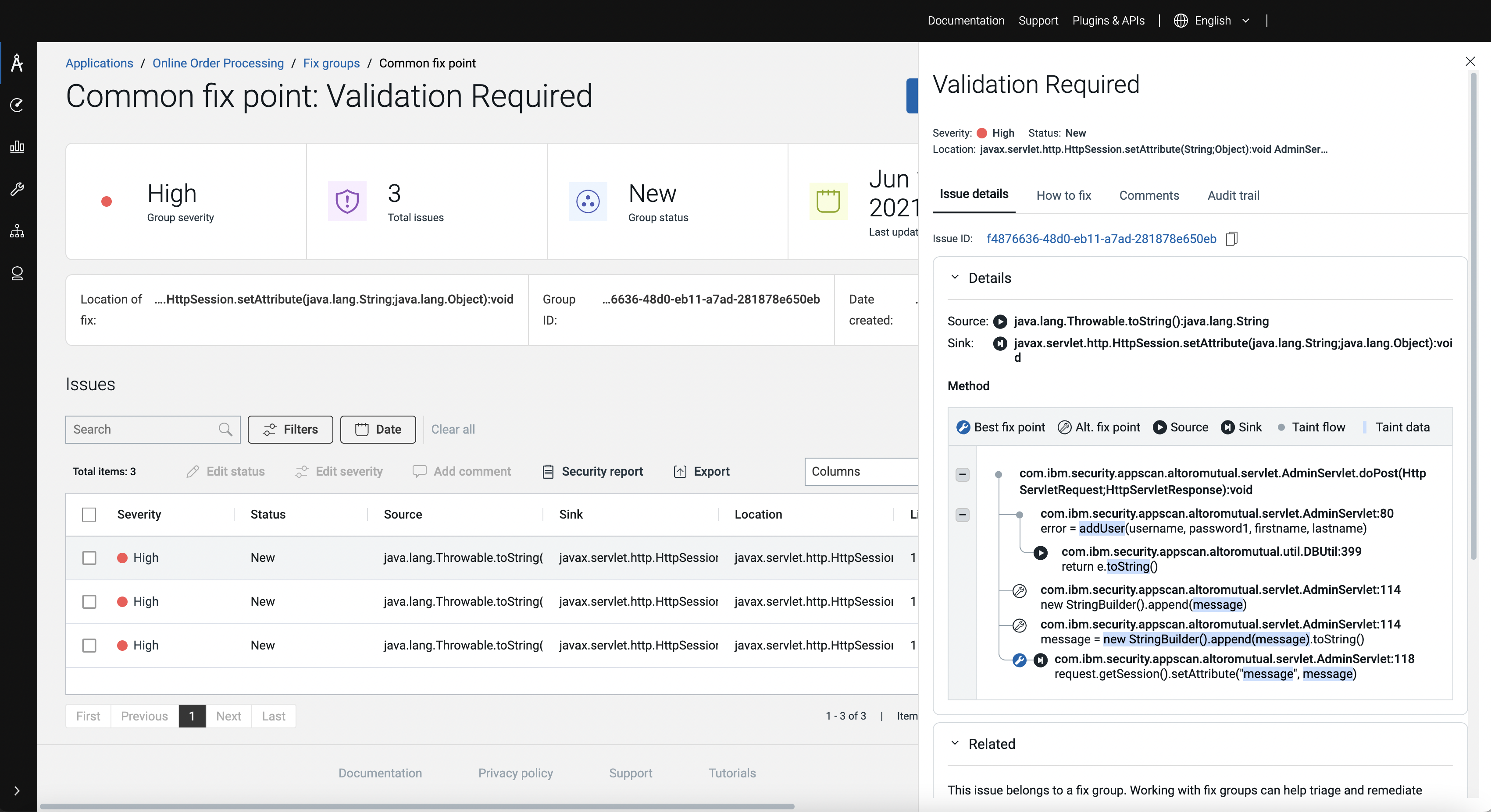

Common Fix Point fix group
In the following image, there are three total items in the fix group; all three can be resolved with one fix. The Issues detail pane indicates the issue source, sink, and the best fix point.
Look for the blue wrench to identify the best fix location. The highlighted text is the flow of tainted data

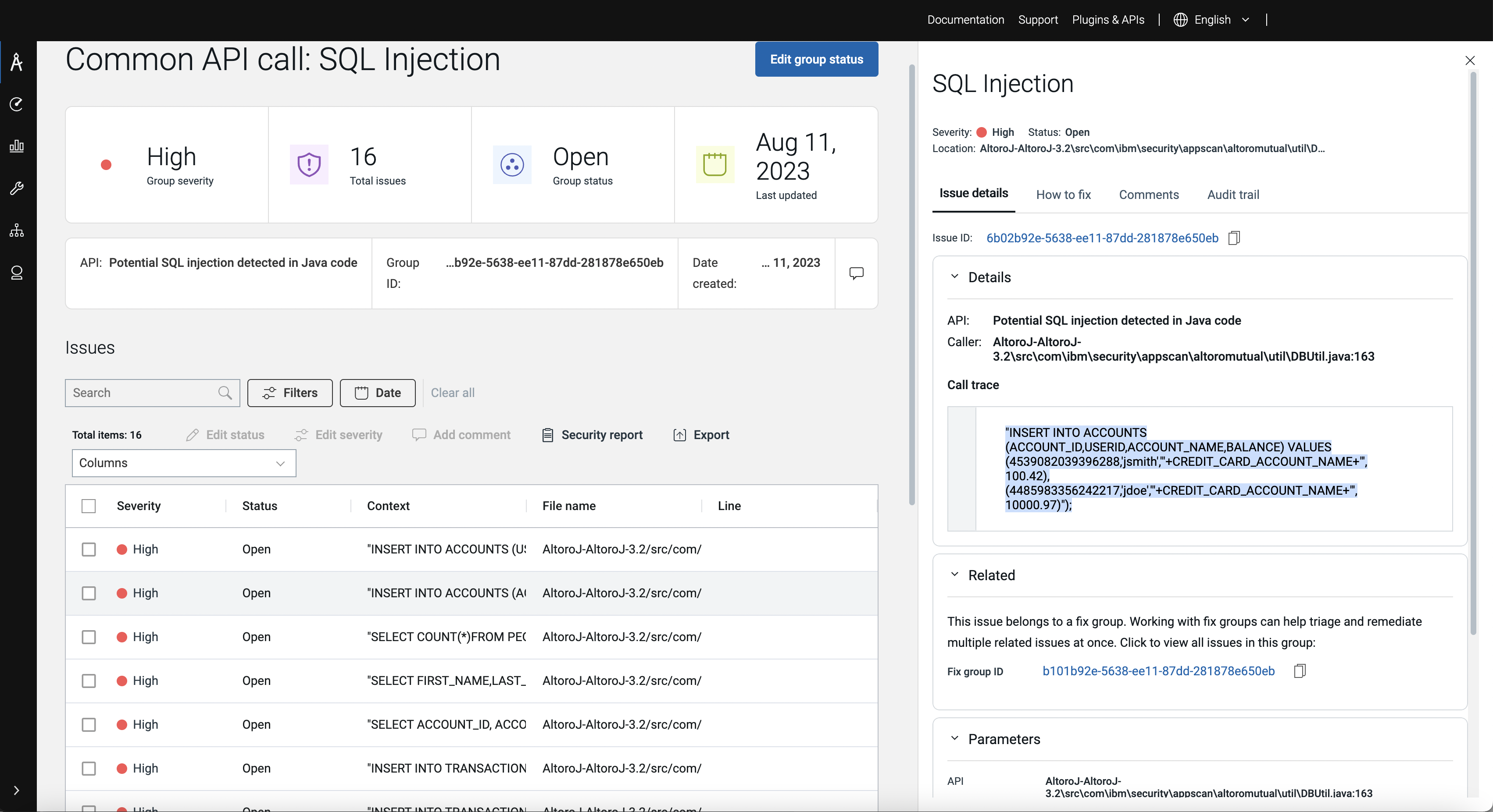

Common API fix group
In this example there are 16 total issues within the fix group that use a common API. They each need to be resolved separately, however the fix is similar or possibility identical in these instances.

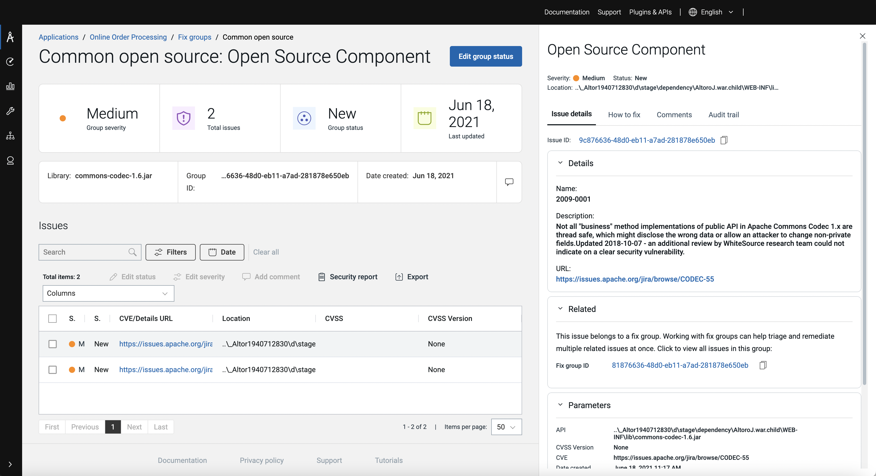

Common Open Source fix group
In this example, the library was found to have two different vulnerabilities. As such, a fix group was created to show all the vulnerabilities for this library and thus speed up the process of reviewing each vulnerability associated with the library.
