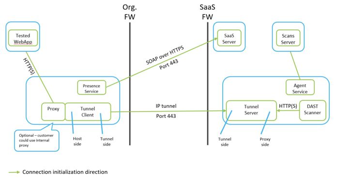

PSS tunneling
Our solution for PSS requires no special changes to the customer’s network that might present a risk to the network. The PSS client that is set up in the customer’s network requires only outgoing access to the Internet (either directly or via an HTTP proxy) and access to the site being scanned.
The solution consists of two endpoints (server and client) which create a TCP/IP tunnel that is initiated by the endpoint on the customer’s (client) side.
Tunnel server
This endpoint resides in the SaaS network alongside the scanner. It is started only when a new scan is started. The server has two “sides” to it, consisting of listening connections (Back-to-Back Servers).
  • The first listens for incoming connections from the tunnel client. This is the tunnel-side.
  • The second listens for incoming connections from the scanner. In this respect it emulates an HTTP proxy, and thus is proxy-side.
When connections from the client are available, the scanner sends the requests to the proxy-side, which are then port-forwarded to the incoming connections on the tunnel-side. When responses are returned by the client, they are forwarded back through the proxy side to the scanner.
Tunnel client
This endpoint sits inside the customer’s network and generates the TCP/IP connections to the server. It performs the same function as the tunnel server, except it consists of two sets of client connections (Back-to-Back Clients). The tunnel client also has two “sides”:
  • The tunnel-side is a set of connections which are initiated out to the tunnel server.
  • The client-side is the set of connections that are initiated out to the scanned server (directly or via a proxy).
The tunnel client performs port forwarding.

Performing a scan
To perform a scan, the tunnel client needs to be started and connected to a server. This is performed by the AppScan Presence framework.
The AppScan Presence framework consists of a Presence Service which runs on the tunnel-client machine. The Presence service polls the Presence SaaS server, which runs on the Cloud and indicates when a scan is ready to run. The exchange between services consists of the scan details, including the IP address of the tunnel-server the client should connect to. In addition it receives information which allows it to positively identify the server it is connecting to. More on this in the Security Considerations section following.
Once a user has requested a Private scan and selected a Presence instance through which the scan should be performed, a scan agent is allocated and the tunnel-server of that agent is started up. A task is then queued in the SaaS server. This task is accepted by the Presence Service, which then launches a tunnel-client with the relevant connection information.
