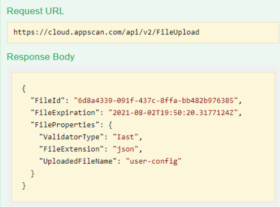

REST API

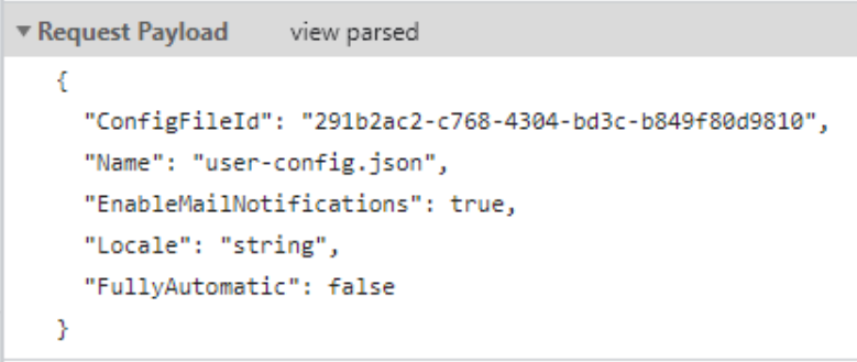

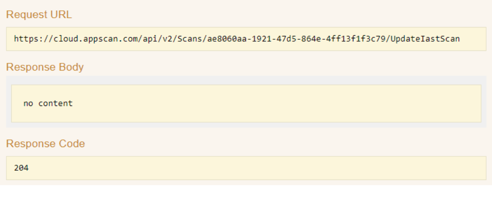

  1. Send request FileUpload. The response includes FileId.
  2. Update your IAST agent with the FileId you received.

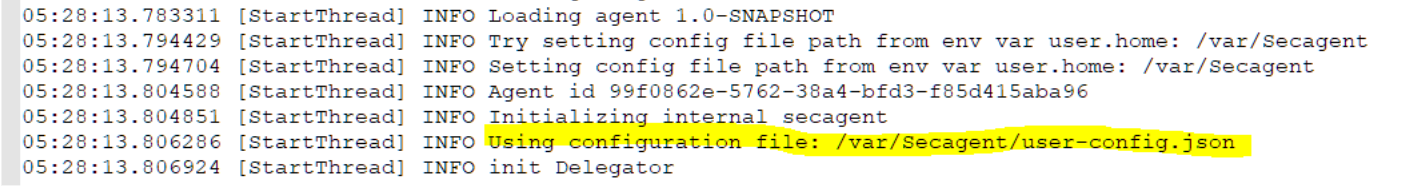

Local file
Deploy the configuration file by copying it to a directory on the server. The deployment location usually is the server temp folder. last prints the location to stout.
Example:

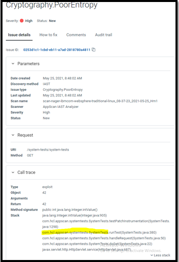

Filter exploits by namespace
Field Values Description
ignoredMethods array of strings
Default: None
Filter out exploit issues (Cryptography.PoorEntrpy, Cryptography.InsecureAlgorithm, and so on) based on namespace.
Note: This exclude all issues from the namespace.
Example:
To filter out this issue and all issues from com.hcl.appscan.systemtests.SystemTests, add:
"ignoredMethods": ["com.hcl.appscan.systemtests.SystemTests"]

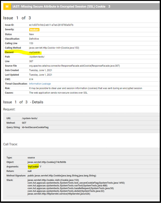

Ignore reports on insecure cookies
ignoredNonSecureCookies, ignoredNonHttpOnlyCookies array of strings
Default: None
IAST reports when secure attribute is not set or http-only attribute of a cookie is set. To filter out a specific cookie, add the cookie name to the configuration file.
Example:To filter out this issue, add:
"ignoredNonSecureCookies": ["myCookie"]

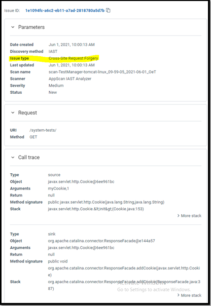

Disable security rules
Example:
"securityRules": {
    "CheckCsrf": false,
    "CheckServerHeader": false,
    "CheckXPoweredBy": false,
    "CheckXAspNetVersion": false
All security rules are enabled by default. Through the configuration file, you can disable some of the report types. Specify only the fields that you want to disable, all others will remain enabled.
For example, “CheckCsrf” : false disables reporting for all issues of this type.

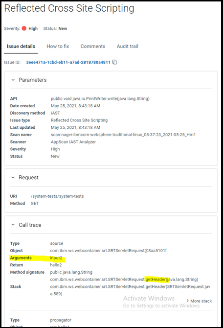

Tip: HTTP Header names are case in-sensitive.
Example:
The source of the following cross-site scripting issue is a header called input2. To filter all issues caused by this input, add:
"safeHeaders": ["input2"]
