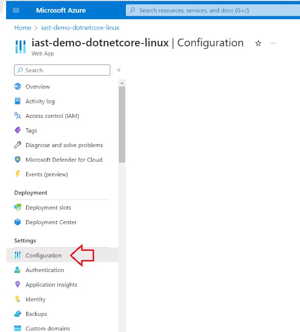

  8. .NET core only: Set the environment variable with these steps:
    1. In the Azure portal go to Settings > Configuration.
    2. In the Application Settings tab, click the + sign to add a new setting.
    3. In the Add/Edit application setting dialog that opens, enter the following name and value:
      Name ASPNETCORE_HOSTINGSTARTUPASSEMBLIES
      Value SecagentCore
    4. Click OK.
