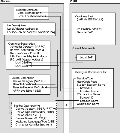

To connect to an iSeries™, eServer™ i5, or System i5™, you need to specify configuration information in the workstation profile that accurately corresponds to the information specified in the iSeries™, eServer™ i5, or System i5™ (referred to as the device description).
For example, the LAN attachment via IEEE 802.2 in the following figure shows how the configuration information specified in the workstation profile corresponds to the configuration information in the iSeries™, eServer™ i5, or System i5™.
Figure 1. LAN Attachment via IEEE 802.2
(Figure showing correspondence of iSeries)
