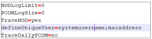

Administrators can mandate license uniqueness, based on different values, by modifying the adminConfig.properties file in the License Manager installed directory.
For Example:
defineUniqueUser=systemusername;macaddress
Below are the available parameters that need to be modified to define uniqueness.
IP address: ip
System user name: systemusername
MAC address: macaddress
Machine name: machinenameAny combination of the above attributes can be used to define license uniqueness. If more than one parameter value has to be configured, then each parameter should be separated by a semi colon (;).Note:- While re-defining a unique user with existing logs, provide a different installation location for License Manager in the servlet parameters (or delete the existing License Manager folder) and restart, to avoid errors during license count calculation.

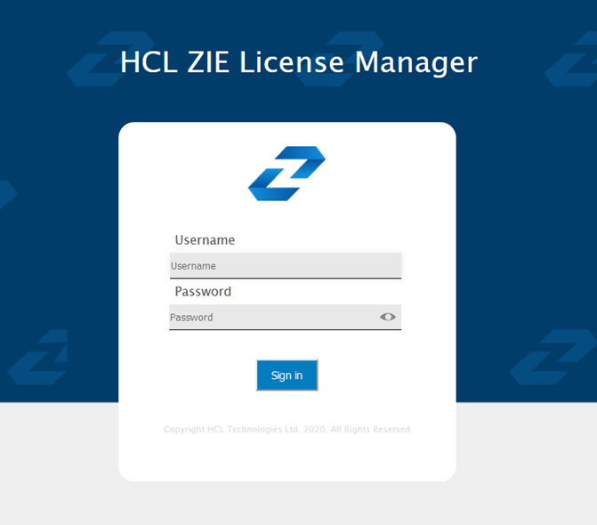

After the successful installation of the server module, Administrators can use the License Logger to monitor the client login from the License Manager Admin console.
The console can be accessed by navigating to: http://appserver-address:port-num/<context-root>/

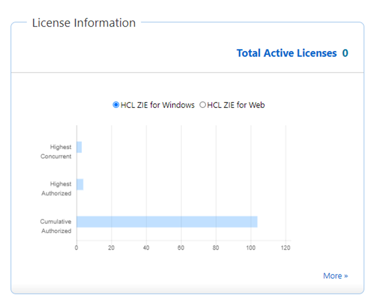

- Total active licenses
Number of active concurrent licenses for ZIE for Web & ZIE for Windows combined.
License Count Statistics:
- Highest Concurrent License Count
The highest concurrent license count gives the maximum number of distinct users who have accessed the product (ZIE for Web and ZIE for Windows) simultaneously, since the installation of License Manager.
- Highest Authorized License Count
The highest authorized license count gives the maximum number of authorized users who have accessed either of the products (ZIE for Web and ZIE for Windows) on a day.
- Cumulative Authorized License Count
Cumulative Authorized License Count gives the total number of distinct authorized users who have accessed either of the products (ZIE for Web and ZIE for Windows) till date, since the installation of License Manager.
- More

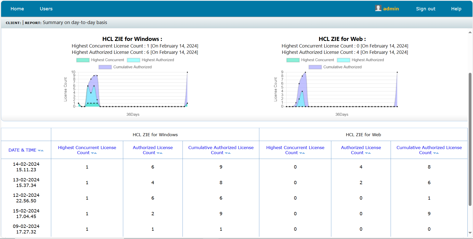

Clicking on the More option takes us to the License Summary Report for both the products combined.
By default, the report shows a daily summary of licenses for the individual products, ZIE for Web and ZIE for Windows. The filter feature can be used to view the license usage for a specified date interval. It includes the following information for each product:
- Highest Concurrent License Count (MM-DD-YYYY)
- Highest Authorized License Count (MM-DD-YYYY)
The tabular view shows the following license details for ZIE for Web and ZIE for Windows with time stamp.

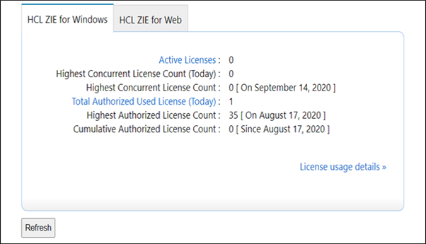

Each section/tab shows the following information for the corresponding product.
- Active Licenses
- Highest Concurrent License Count (Today)
- Total Authorized Used License (Today)

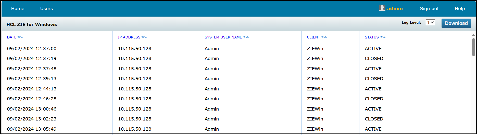

Log level
This option is available on "License usage details" page.
Select the log level (from 1-LOW to 3-HIGH) to filter the number of entries to be logged. The default log level, which is Level 3 (HIGH), logs all the entry parameters, including connection closed entry along with the periodic client check-ins. All the other log levels (1 and 2) will log only the first client check-in and the connection closed entry.
Following are the parameters which are logged:
- IP Address of the client
- System User Name
- Machine Name
- MAC Address
- Client Type
- Status of connection
- Timestamp
Level 3: All Parameters
Level 2: Timestamp, IP, System User Name, Client Type, Sub-Client Type, Machine Name, Connection Status
Level 1: Timestamp, IP, System User Name, Client Type, Sub-Client Type, Connection Status
The license usage report containing Log level 3 (HIGH) with license usage information can be extracted by the Admin into a .csv file (that can be opened as an Excel Workbook).

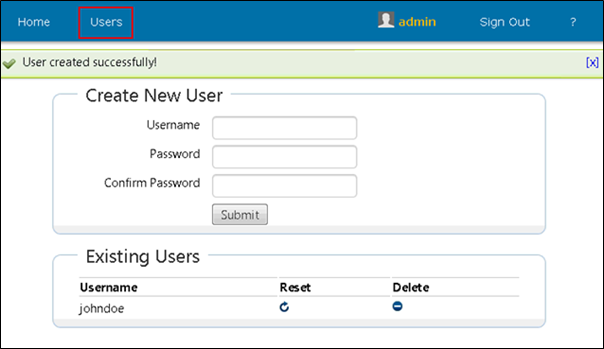

User Management:
To create a new user, follow the below steps:
- Go to the Users tab.
- Specify the Username (username is not case sensitive).
- Specify the required password (password length must be between 5 to 20 characters).
- Re-enter the password in the Confirm Password box.
- Click Submit .Note: The Admin can create new users for the license manager.
Under the Existing Users section, there is an
option to delete the existing user by selecting the icon
next to the username.
If required, Admin can reset the password for a selected
user to the default password (password), by clicking the icon
next to the username in the existing users
list.

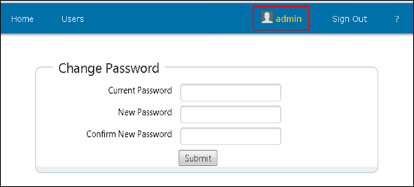

Users can change the current password, by hovering the mouse pointer over the Username field displayed on top of the screen. After specifying the current and new password, click Submit.
