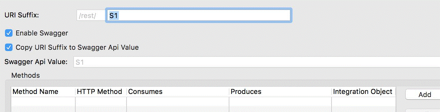

  6. On the Configure JAX-RS Resource class page, in the URI Suffix field, specify a suffix to create the complete URI to use in mapping to your JAX-RS resource. For example, if the host where the ZIETrans RESTful service is installed is www.myHost.com, the ZIETrans project (application) name is myApp, and the URI Suffix is mySuffix, then the resulting URI for the JAX-RS resource is http://www.myHost.com:9080/myApp/rest/mySuffix.
    Note: The combination of URI plus HTTP method must be unique among all of the JAX-RS resources that you define. If not, the JAX-RS runtime picks only one of the resource functions to invoke based on a priority algorithm using the combination of consumes and produces content types (see Customizing RESTful service JAX-RS resource methods).
  7. By default, Enable Swagger is selected. You can disable it if you do not want to include Swagger support. By selecting Copy URI Suffix to Swagger Api Value, you can automatically copy the URI Suffix value to the Swagger Api Value field. To enter a new value, you can uncheck the Copy URI Suffix to Swagger Api Value. The value of this field will be added to respective service as annotation @Api by ZIETrans toolkit.

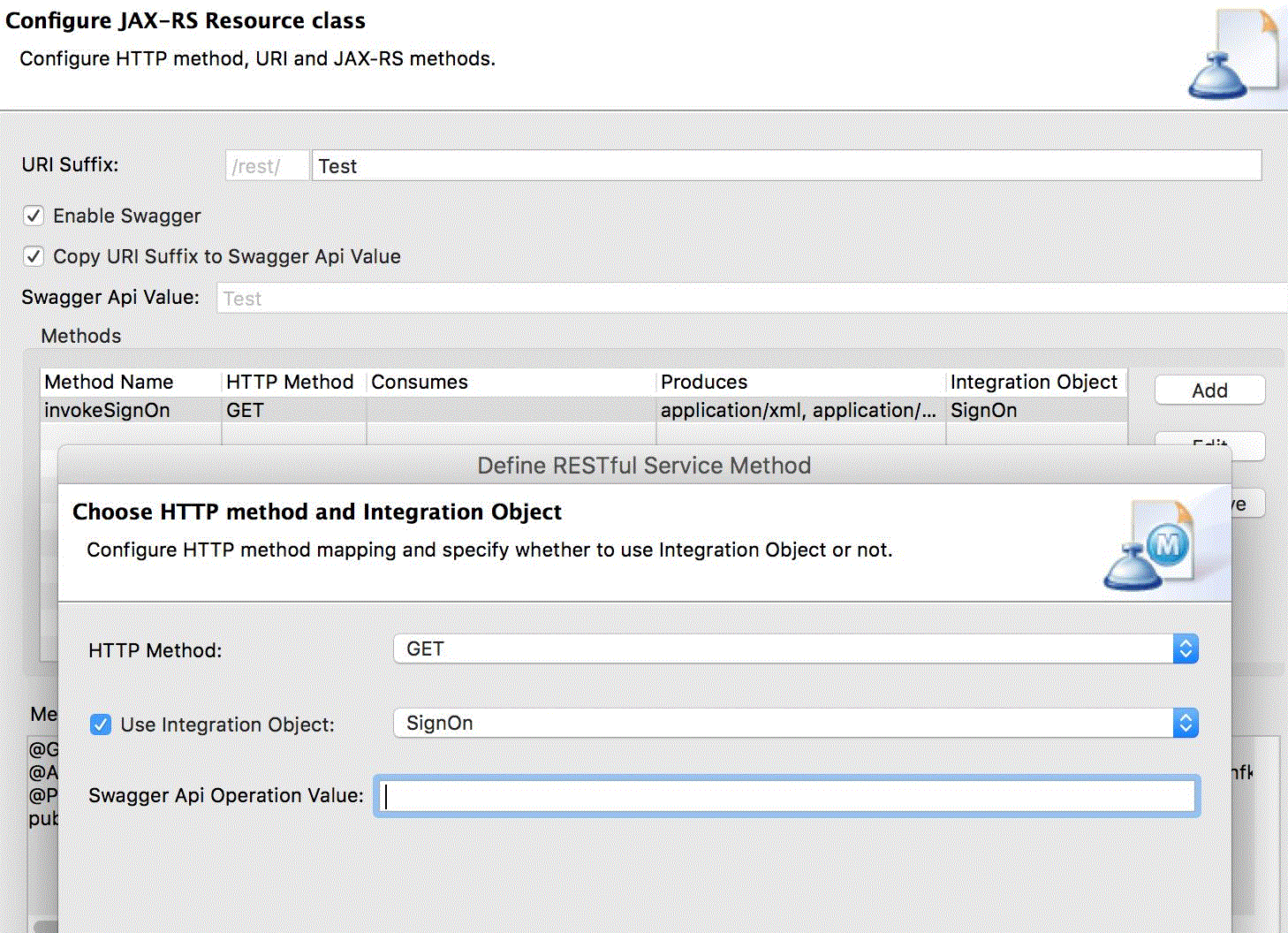

  8. Click the Add button to add at least one method to the resource class. The Define JAX-RS RESTful Service Method wizard opens.
  9. In the HTTP Method field, from the drop-down list, select the HTTP method (GET, POST, PUT, DELETE) you want to use in combination with the URI to map to this JAX-RS resource method.
  10. Select the Use Integration Object box if you want this method to invoke an Integration Object. Clear the box if you want to generate an empty method without the Integration Object handling code. Do this to create your own customized method.
  11. If you select the Use Integration Object box, from the drop-down list, select the Integration Object you want this method to invoke.
  12. If Enable Swagger is selected in the previous step, then you can enter text in Swagger Api Operation Value field. This field will be ignored if no value is entered by you. The value of this field will be added to respective method as annotation @ApiOperation by ZIETrans toolkit.
